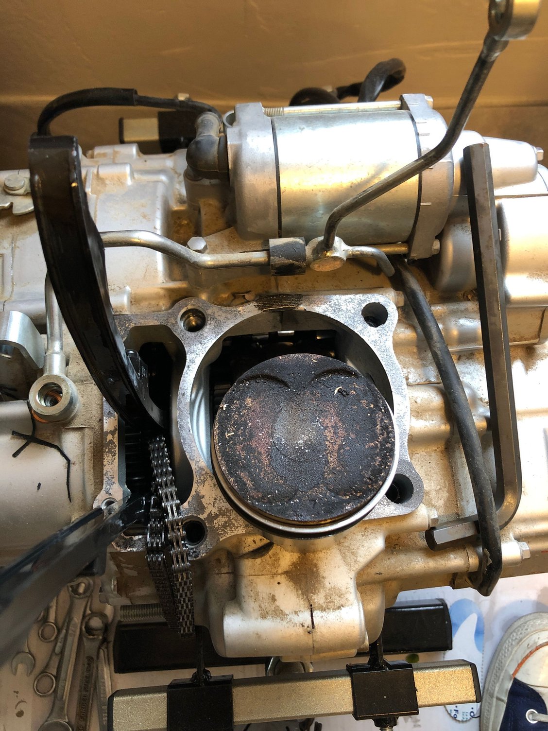

This is the used engine I picked up. Glad I went with the 351 kit

How do I take the piston out?
Old Jun 1, 2019 | 01:22 AM
  #35
ctbale's Avatar
Joined: Apr 2019
Posts: 86
From: Gustavus Alaska Sea-Level
take out the circlips and push out the pin
I was thinking sawzal or a cutoff wheel...

take out one circlip and push out the pin. if it won't go, heat the piston. propane torch works good

oh and cram some paper towels down below the piston to stop the circlip from going down onto the crank cavity
...And be ready, as it won't simply drop down the crank cavity. It will ricochet off of at least three walls (possibly the ceiling), hover spinning in mid-air for just a second, then drop down at a physically impossible angle and slip into a small gap you left when blocking off the timing chain well.

Gotcha. Thanks y'all. Piston is now released.
And judging by the condition of the piston, is there anything else I should be inspecting?
