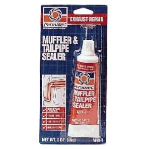

Originally Posted by Arctra
...... Clearly it is not sealing properly Does anyone know if this is going to be a problem? Is it OK to leave it like that, or do I need to get some sort of seal sorted out to prevent any pipe damage?
You can get some sealant so apply to the joint. Looks like the leak is minor, but it will increase the noise from the pipe as it draws air into the system. Permatex RTV high temp silicone or Permatex exhaust sealer are the go. Supercheap Auto has them both as does Repco.
Nice ride report BTW.
Thanks for that. Now please excuse my ignorance, but will I have to unclamp the joint and insert the sealant in the joint, or can just apply it to the outside? I'm guessing it's the former, but hoping it's the latter
I guess if I am to replace that clamp I will need to open the joint anyway. I am reluctant to though as the guy who did it said it was a bugger to do and needed 2 people

Yes. You should really remove the slip on to fit the sealant to a nice clean joint. It looks as if the pipe has slipped a bit and that has caused your leak. The best way to fit the pipe is a "dry" (no sealant) fit first with all bolts LOOSELY fitted (this includes the header,) and once it all fits up well, tighten the header in place, tighten the tailcan to the mid pipe and then remove the slip on complete. This is when you can add the sealant to the header/slipon joint (add the clamp to the header at this point.). Tighten it all up with the new clamp and away you go.
Too many people don't loosen the header to fit a slip on and force the pipe into a joint with a lot of tension in it. This always results in a leak. The pipes when dry fitted should all line up with minimum tension on any joints. You shouldn't have to force it. The other downside of an exhaust fitted with to much tension is the inevitable break in the pipe work at the area with the most stress.
