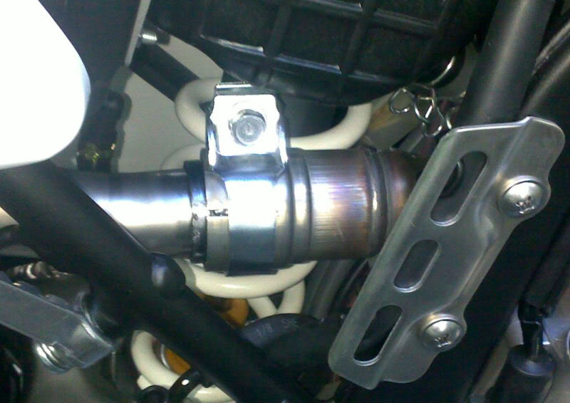

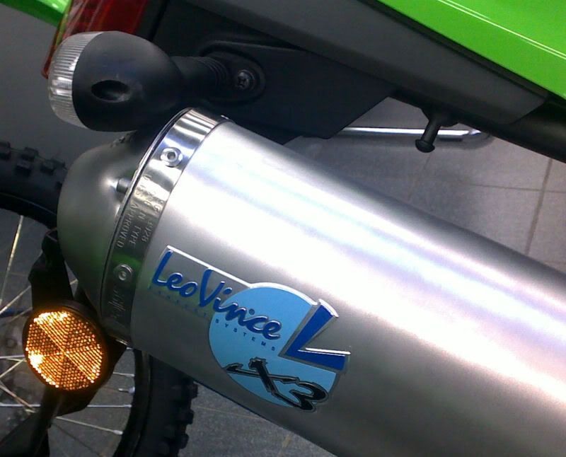

OK, so I was just back at the dealer and had a closer look at the 2010 KLX250S they'd fitted a Leo Vince X3 to. Took some pics too and you can see that the header pipe is a much larger diameter than the Leo Vince Slip-on (well, I would technically say "slip-in", but anyway ). And to back up your assertion that the Aussie header is about 1" longer, take a look at the second pic where the muffler is actually touching the indicator!

Yup. The header is too big for the Leo' that is designed for the USA spec KLX250S. You need a muffler designed for a KLX300R OR a full system for either model.
BTW, they can only get away with fitting it all is because the Leo' has a sliding clamp for the muffler. If it was a Muzzy or FMF it wouldn't fit at all.
"Bodge! I'll leak in 500 km."

Yeah, it was just nice to be able to confirm it on the latest model KLX rather than taking a blind punt and hoping to get the right slip-on.
I would presume you don't think it's worth going for an aftermarket header pipe given we get the KLX300 header then? (and because you just have a slip-on)
