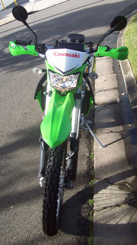

Sorry, I forgot to take close-up's, but here's the girl with her pretty new decals after the pipe fitting.

Arctra, what is the white piece on the left side above the kick stand? Is it a hand made guard for keeping your foot out of the chain?

Hey mate. It actually came standard on the bike - presumably to stop oil/water flicking off the chain onto yout boots. Dunno. It's soft and flexible, so if it gets up getting pushed intot he chain or anything it'll just get shredded. I didn't see any point in taking it off when I took the chain guard off.

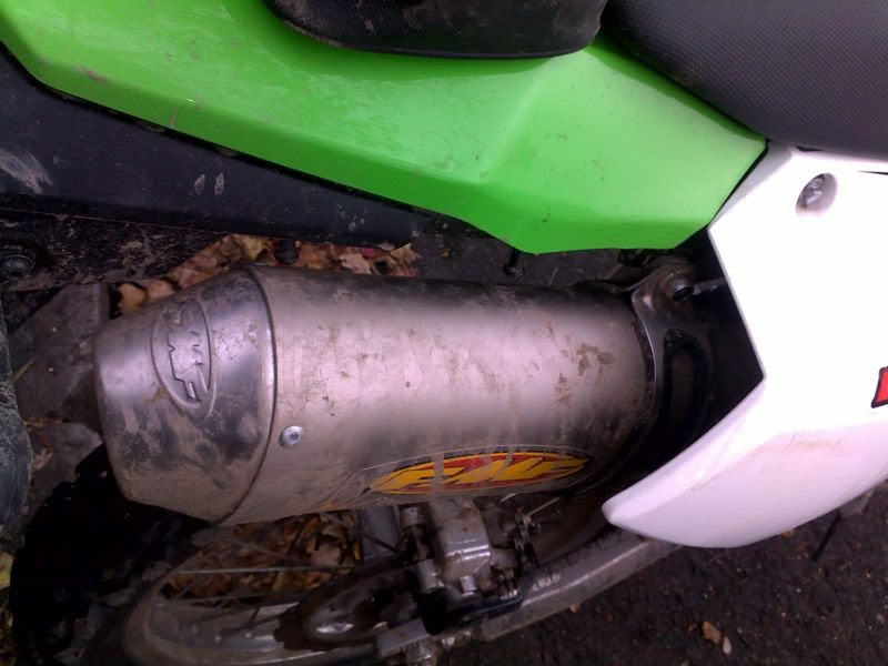

OK, just remembered to take some close-up pics of the slip-on, and am glad I did. Sorry the bike is still dirty (well, I'm not really, but anyway) as I did not get to clean it after I got home last night.
Here's the muffler. You can see it fits nicely with respect to the indicator, and it's had a few washers put in where it attaches to space it away from the mudguard:

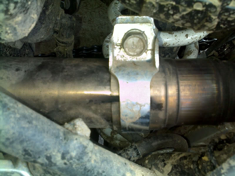

Here's where it attaches, and I've just seen a problem. Clearly it is not sealing properly Does anyone know if this is going to be a problem? Is it OK to leave it like that, or do I need to get some sort of seal sorted out to prevent any pipe damage?
