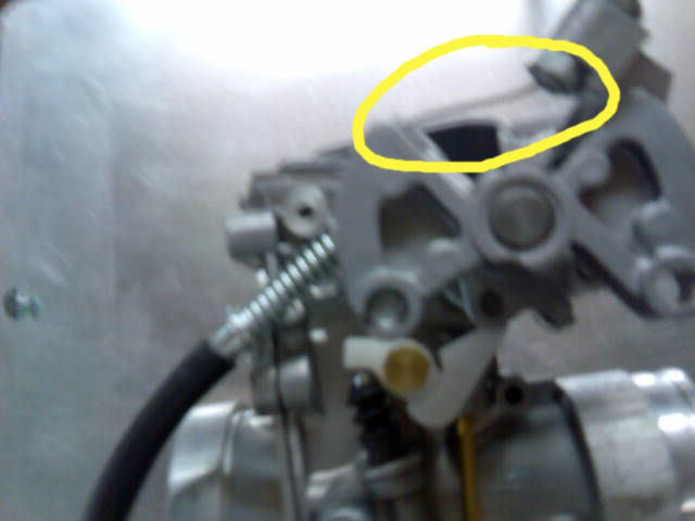

Thanks for the reply, Here's a pic.
Look at the angle of the throttle cable inner, surely if you ran it like that it would put a lot of wear on the wire strands that make up the cable?

Bill's carb works perfectly, but as I said in an older post it sure is a tight fit. My throttle cable is a little more square to the carb than yours. My problem is the cable adjuster contacts or almost contacts the valve cover. I had to **** the carb to about 1 o'clock relative to the engine. Make sure the cable bracket sits square in the carb........the angle of attack that you have now will wear the cable. Earl

I don't have a modified carb on hand at this time hopefully they will be in today or tomorrow. Looking at the angle of the cable mount in the photos I think you installed it wrong there is a hole in the lower part of the bracket just under the countersunk screw that fits over a boss make sure the hole goes over the boss.
Bill
Hi Bill thanks for the reply! You don't have a pic handy of the way it "should" be do you?
Or anyone that has fitted this? If you could take a pic it would be greatly appreciated!

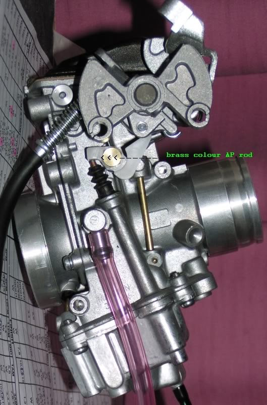

hard to tell your pic is blurry but here is a pic of mine

Bake, thanks so much for the pic, its defiantly worth 1000 words
I'll post back results when I get some time later this week hopefully!
