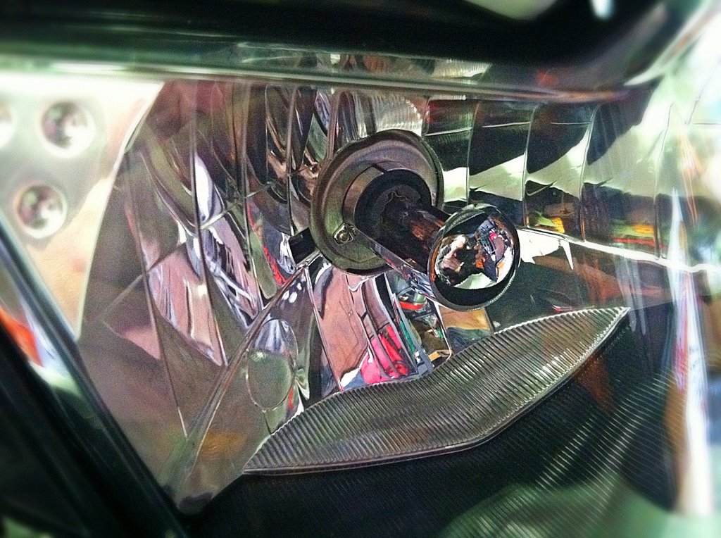

I used the H4 high/low 5000K motorcycle kit
not sure what they call it exactly online
and like I said full lifetime warranty
one thing I did not like, because ive bought so many of these kits is they gave me the typical dual light wiring harness
so you have a socket that wont be used, and I just tucked it away
and the power wire barely reaches the battery but you can make it work. And they forgot to include the fuse but thats a freak thing.
Other then that its plug and play you just need to run the wire to the battery but its all included in the harness for the high/low
Low beam only does not come with a harness so you either make one or buy one
its cheaper to get the high/low it comes with the free harness
I just figured the motorcycle package would only have one socket on the harness not 2
but its not a big deal
and the ballast will fit behind the headlight area its super thin

the bulb also has I guess its called a casper shield
its supposed to be better then the previous hid's that came out years ago
I think cuts down on the splatter they give off not being in a projector lens
so far only my high low have these, the low beam only I have dont
