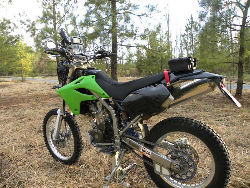

Old Jan 30, 2013 | 03:40 AM
Old Jan 30, 2013 | 03:44 AM
I think Redpillar had a rally light on his for awhile too. You might find something about that here on KF .
The pic i posted was in the KLX thread on ADV a while ago.
KLX 250 Rallye bike build. - Page 5 - ADVrider

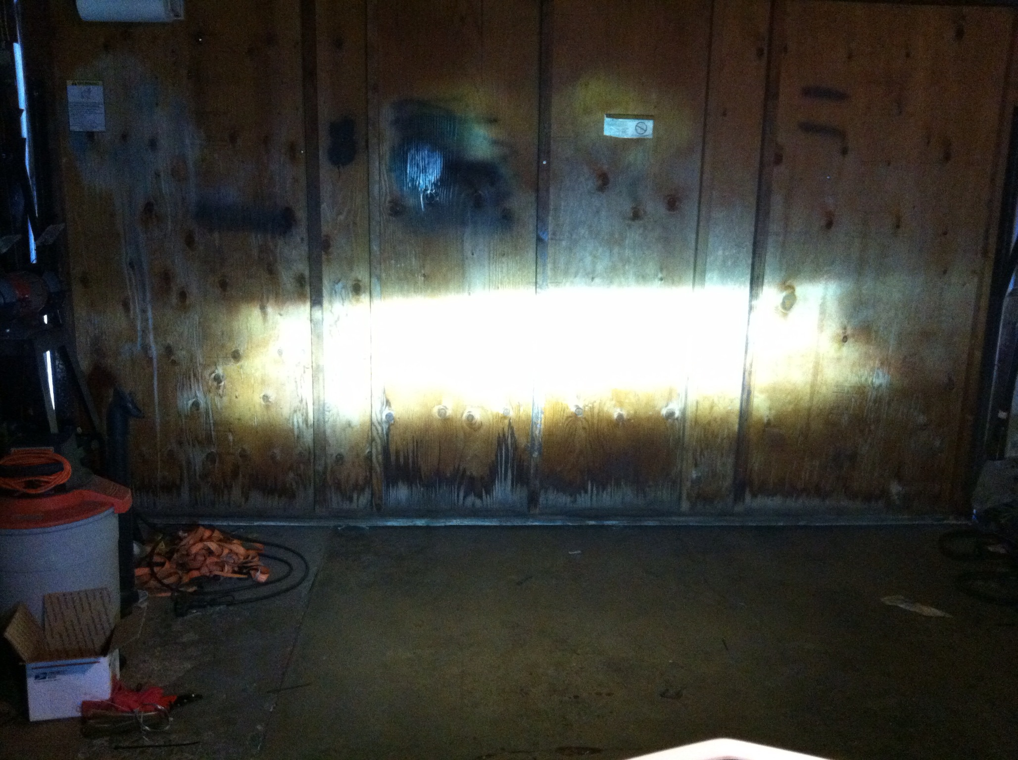

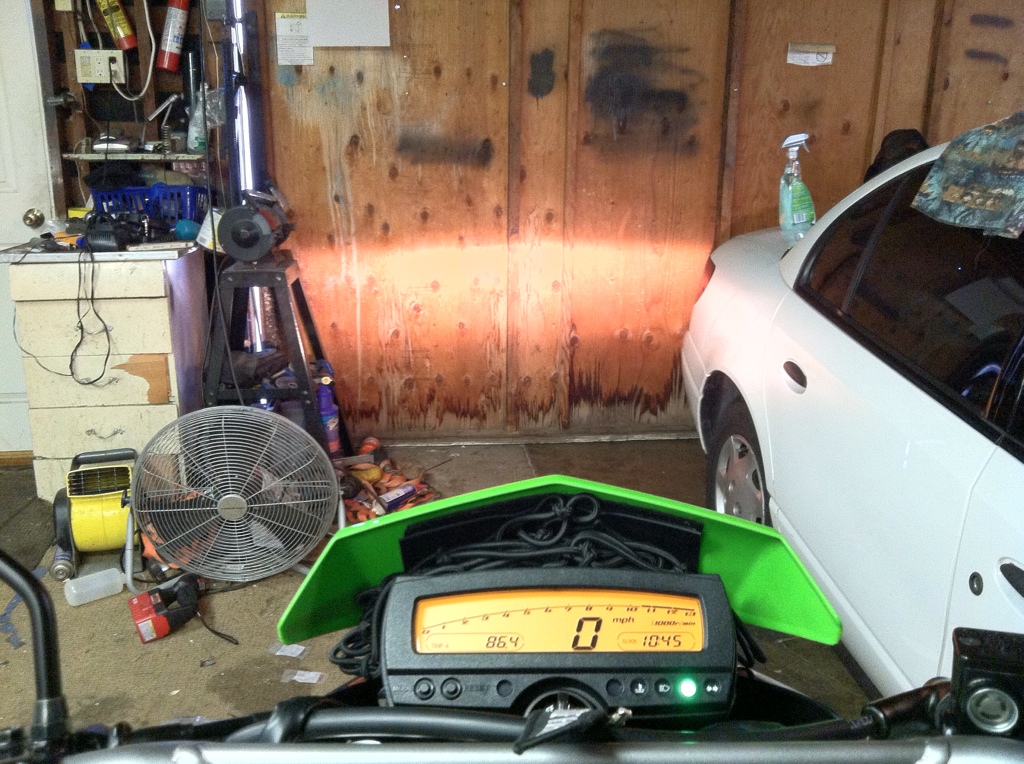

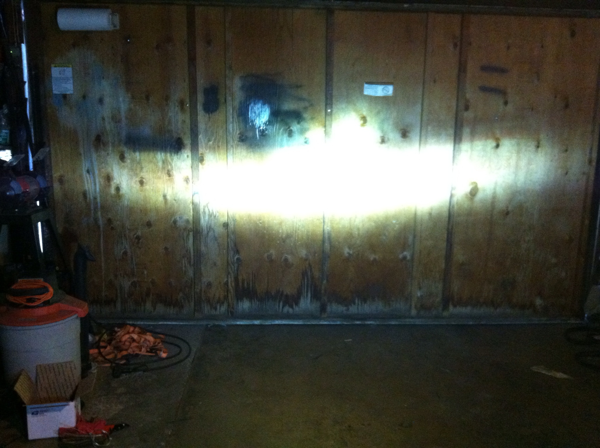

Old Jan 30, 2013 | 04:56 AM
MikeW's Avatar
Joined: Sep 2012
Posts: 434
From: Sandy Eggo
Low hid
high hid
stock

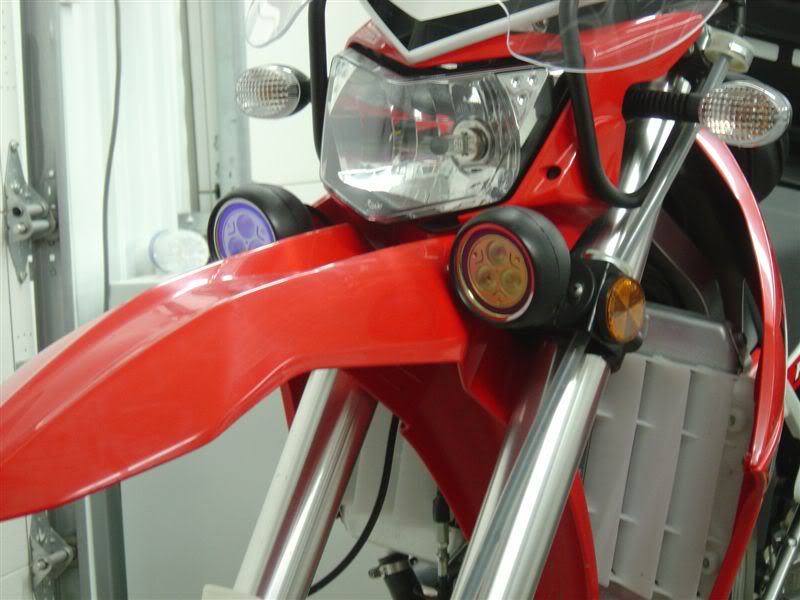

Old Jan 30, 2013 | 05:00 AM
DYNOBOB's Avatar
Joined: Sep 2011
Posts: 304
From: Cincinnati, OH
Don't know if OP runs heated gear/grips but there's a lot of good LED driving light options out there now. I'm looking at some ADVMonster's to replace my homebrewed leds.
