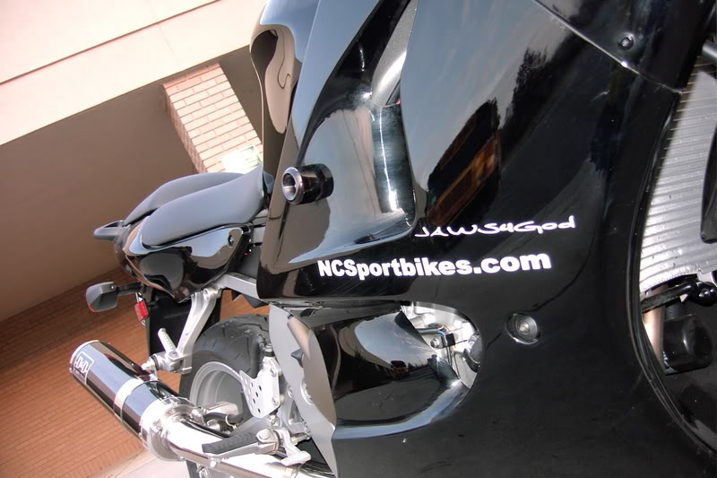

first I had these:

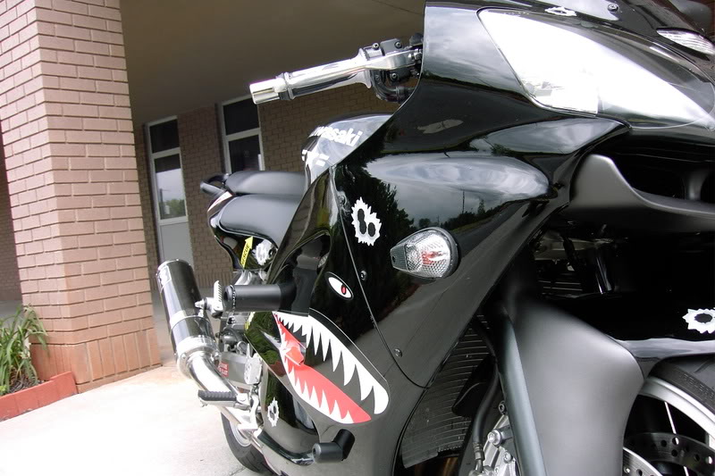

but I wondered if they'd really help save fairings.. so I got longer ones, like this:

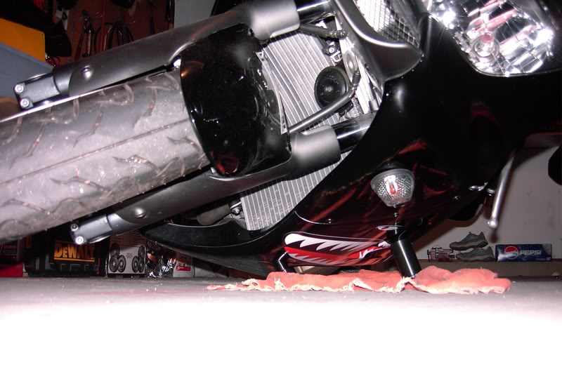

and laid it down to test, and they BARELY save as is.. so i'm sure those short ones would still cause damage to the handlebars, mirrors, and lower fairings..

I just got some no cut frame sliders and I got alot of different opinions. Basically I was told they're only any good if your bike tips over in a parking lot. At any other speed you're F'd.

i know they're called frame "sliders" but everyone i've talked to have said all they really do is cushion the initial impact. all the bikes that i've seen go down with them on they've busted off. but i guess if your lucky enough to only have the case covers scratched than broken they are a good investment.

R&G make one of the best frame sliders as they bolt to the motor mount which significantly reduces the sliders from breaking when going down. If you are bolting them to the plastic, they won't work and will rip right off.
They even supply the modified coolant tank being the sliders bolt through the coolant tank. Just look up a 00-02 ZX6R

I don't remember the brand of the first ones i had.. just a cheap ebay one.. but they were no cuts.
The longer ones I have are T-Rex frame sliders for a Honda F3 I believe.. I just looked for something symmetrical.. then I just had to get long bolts from Lowes.
I didn't want to spend the $100 or so for R&G... these sets were all about $20.
