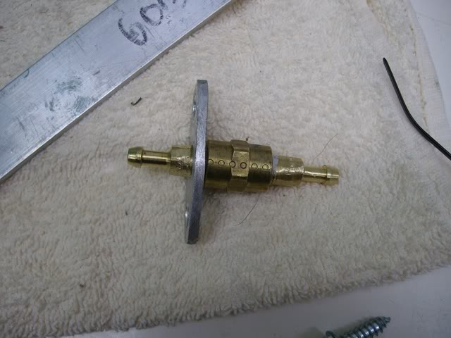

Red, I saw that write-up and it was helpful. My Arctic Cat pump is on order. You say you used the stock petcock but it doesn't really show in the photos how you accomplished that. If you could tell us how you did that I'd appreciate it.

I made a fitting to go into the tank.

It is made of standard fittings, I ground the one that goes into the tank so it would fit through the hole. I made the aluminium plate and threaded the fitting through it and used gasket maker to seal it to the tank.

Then I ran a fuel line fromt he tank to the pump inlet and then to the stock petcock which I ended up mounting on the outside of the bracket and I think I actually spaced it out with a washer to clear the tank a bit better.
You have to plug one of the outlets of the petcock so there is no reserve but you can see through the tank which in my opinion is better than having a reserve.
Hope this helps.
