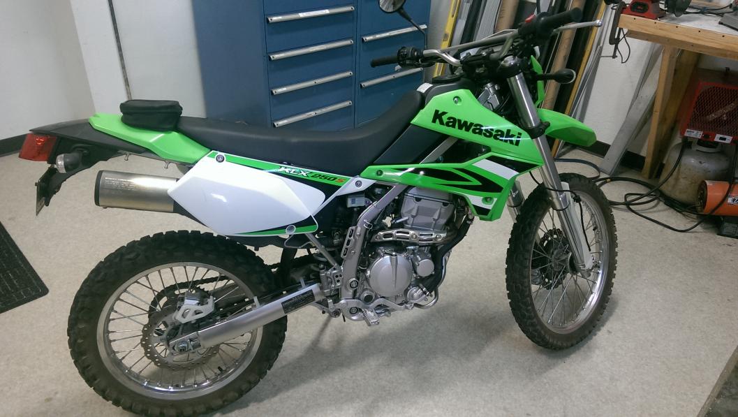

Great forum guys. I just took ownership of my "brand new" KLX250s, actually a 2009 with only 700 miles on it and never on the dirt! Picked it up on CL for $3k. It's got more dirt on it now from my back yard and now is starting to look like a dirt bike.
I just finished re-jetting with the DJ kit and it is quite a different bike. Also pulled off all the "extra" hoses and canisters. Now I'm looking for a block off plate for the outlet near the exhaust header. Anyone know where to get one? Maybe I'll just CNC one myself.
Dave
