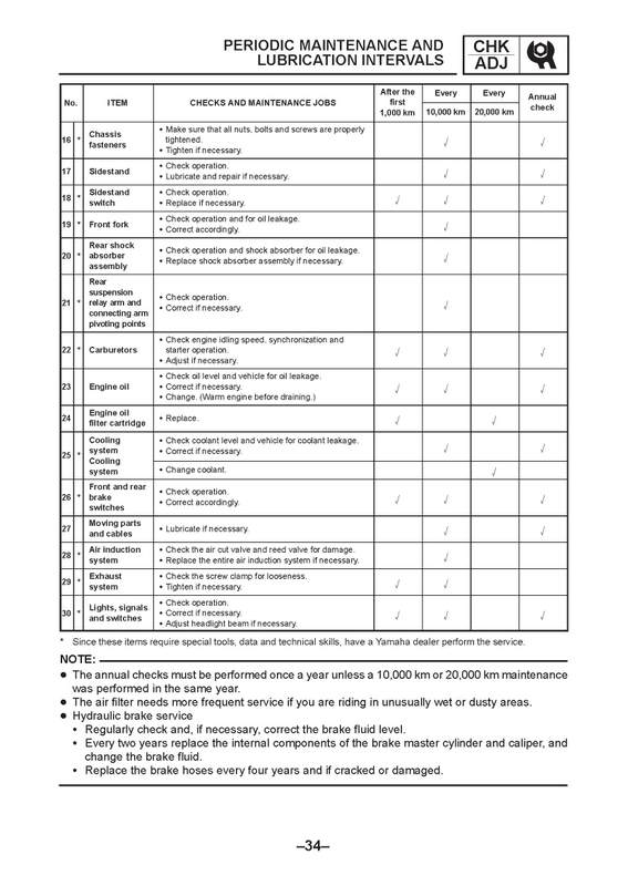

Filter above the oil level or not, my manual says and I thank all three of them say 4k for oil and 8k for the filter.
I guess this wouyld be for regular oil and not syn. I use syn in my bikes and replace oil and filter every 5k!

Which manual is that NS? change every..(km) I see that you do not follow the manual as well.
