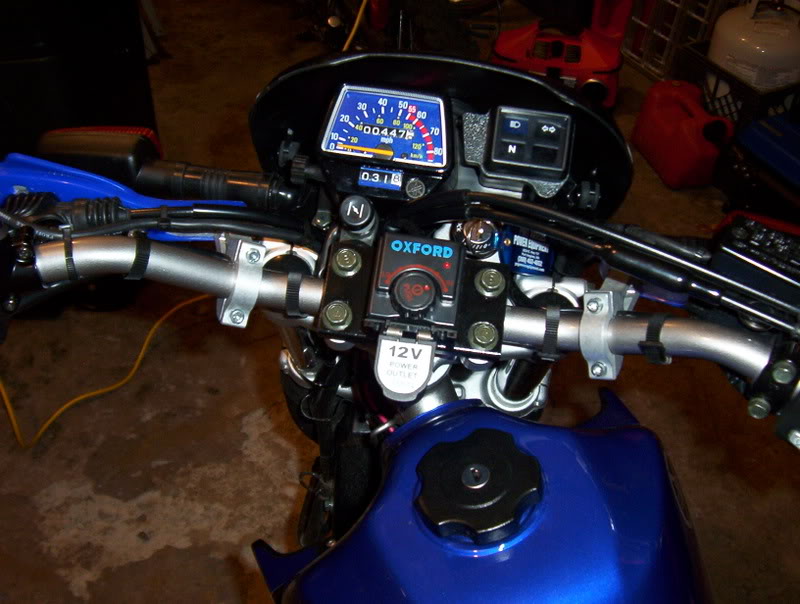

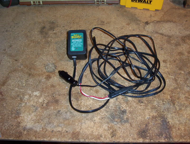

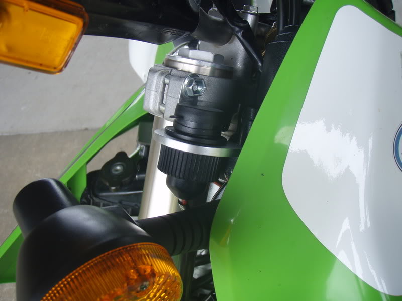

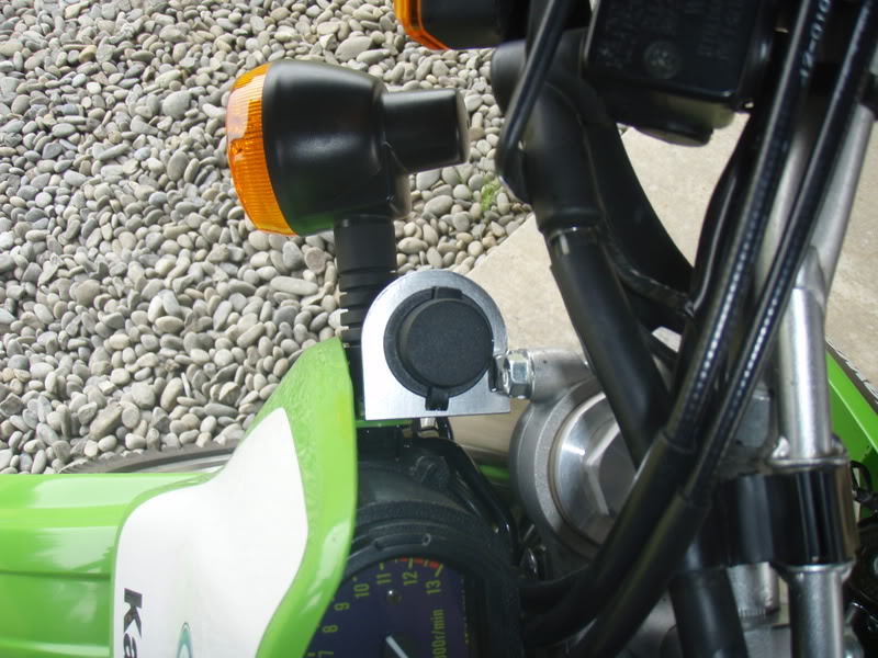

I installed on both bikes and now have a way not only to charge a phone or run a GPS, but I can also quick connect the battery maintainer so I don't have to take off side panels, and bonus I can jumper between both bikes in case someone ran their battery down by leaving the light on...(no names to protect my wife) LOL
Yeah its an awesome mod for the bike. I keep the blackberry charged in the tank bag. I added one on the wife's bike as well. Plus she got the heated hand grips.
It's also nice since the bikes can both be reversed charged with the battery maintainer. Just plug and play baby!

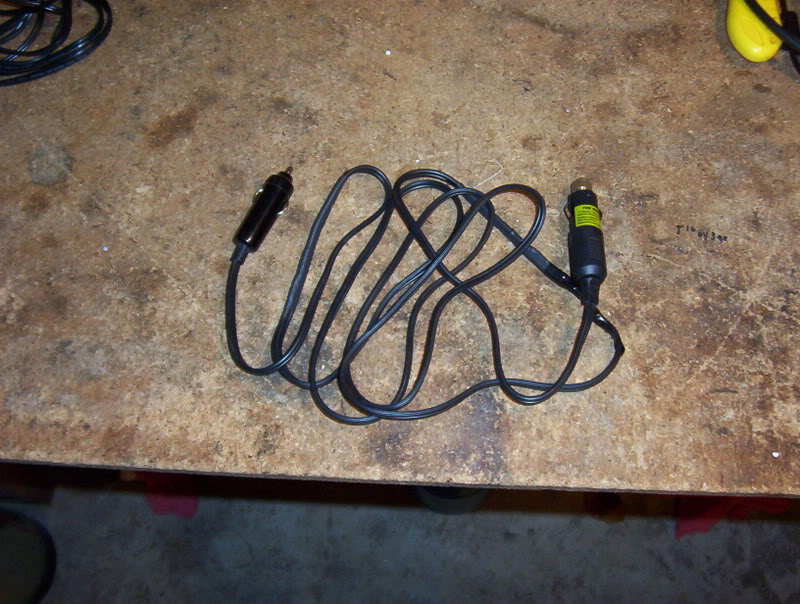

And bonus, I made a plug in jumper that works great. That way if someone leaves thier key on and the battery gets low, all I have to do is plug in and wait 3-5 minutes, and it will fire up the dead bike. Already tested in the garage.
