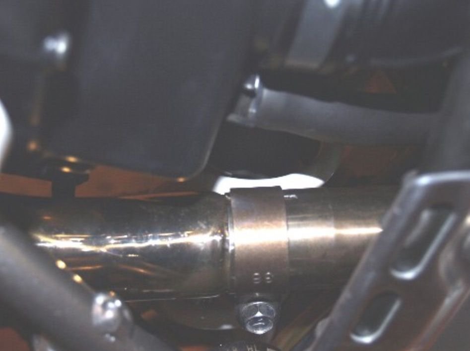

Here's a pic of a fmf power bomb installed with a two brothers canister. No composite gasket used. I cut relief slots in to the bell/ flange going over the nipple/reduced slip fit intersection similar to the stock arrangement. No rtv/silicone needed since it's not leaking at all.

Thanks Racegass. it is obvious that the TBR slipon is compatible as there is no gasket involved and the clamp is not deforming the PowerBomb's slip-joint-bell in order to get a seal on the TBR nipple..
