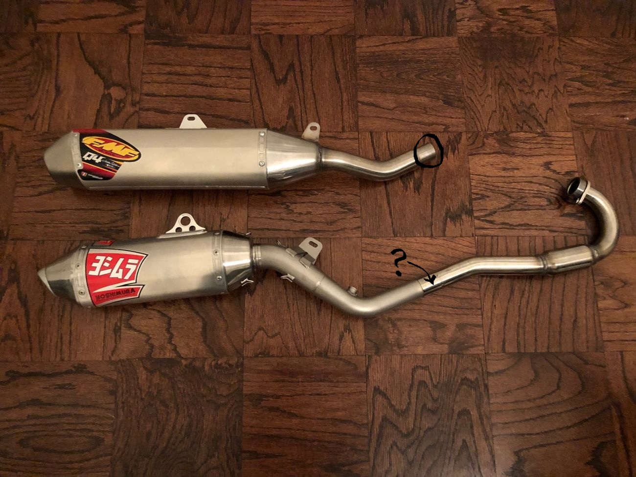

Hmmm. I'm still not sure I get it. You're saying that the stock header is somehow less restrictive than the FMF Powerbomb even though the fitment of the Yosh midpipe into the Powerbomb header is the same as the fitment of the Yosh midpipe into the stock header? Sorry if I'm a little slow. Here is a pic of the FMF Q4 (before I returned it) next to the Yosh connected to the Powerbomb header. does that help answer our question?

Unfortunately, your pic does not answer the question - as to whether or not the Yoshi is compatible with the FMF headers..
I have circled the nipple of the Q4 - the Yoshi nipple is not pictured, but it will need to have the same exact dimensions of the Q4 nipple before it should be used with a FMF header.

The Q4 almost doesn't even need a clamp. It is a tight fit into the PB slip-joint (bell). All you need is just a thin smear of sealant on the nipple that is allowed to cure before running the engine. If the Yoshi is compatible, it will fit just as tightly and only need a thin smear of sealant in order to seal into the PB as well..????

Ah. I understand now. I'm pretty sure the nipple on the front of the Yosh midpipe is smaller than the Q4, Bummer.
