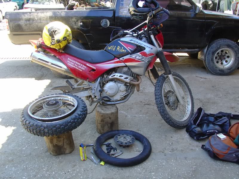

Well I like the snails on my bike, BUT during a field flat fix the old style is real nice...just slide out the axle, repair tire and all is preset....real nice on a rental bike in say Costa Rica
