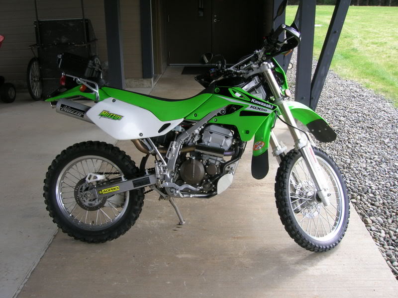

I mean what's next mudflaps on the front fenders?

they SAY its because its more adjustable...you can get the chain exactly where you want it. Plus you can remove the wheel and put it exactly back to where it was with no further adjustment.
But seriously....All you gotta do is remember that "my chain was on setting 4". Is that so hard? Plus a chain is an approximate adjustment, not exactly. I'm sure setting 5 or 5 1/2 is more than adequate and in the realm of acceptable limitations. Plus, even if you do have to adjust again, it will take all of 30 seconds like said before.
Another WTF Kawasaki moment.

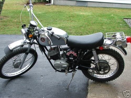

Deej is that Hodaka yours?
