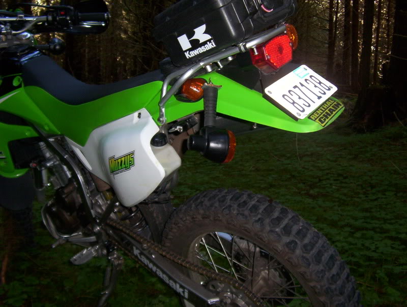

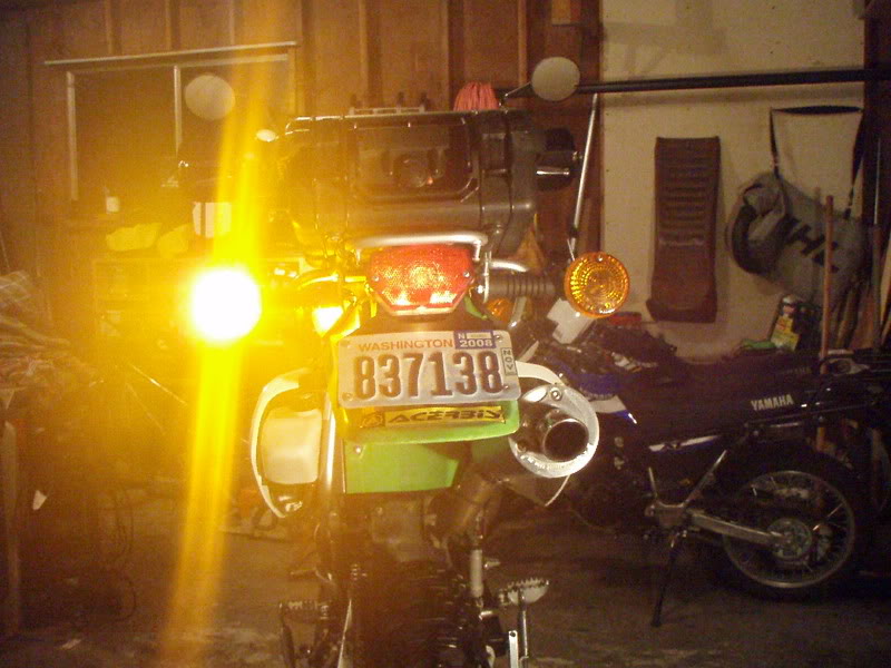

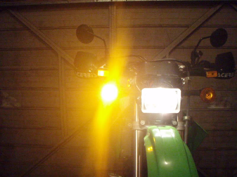

Dang, that sucks! Is it mounted to the rack like on the 06 bike? If so it probably bent the tab, and from my experience the tab will only take a couple of bends before it snaps off. When I cleaned up the back end of the bike and installed the smaller lights I bent the tabs in on purpose, then later I decided to put the stock lights back on because they are 5 times brighter than the smaller ones and when I tried to bend the tabs back I could feel them giving out. I took it to a shop and had them re-weld. Here is the back of my bike as it is currently. Yes I have 8 blinkers now. But hey it can only help right? Follow the wires back, unplug them from under the seat, and think about buying two of the same lights that are available in a bike shop with round lenses and keep the odd one you will have left over as an emergence replacement.
Here you can see the difference between the small ones I mounted on the fender and the stock ones that I put back on.
Same thing on the front.
Hahaha I just found a picture of when mine broke off after I put them back on. Yea the original welds sucked.

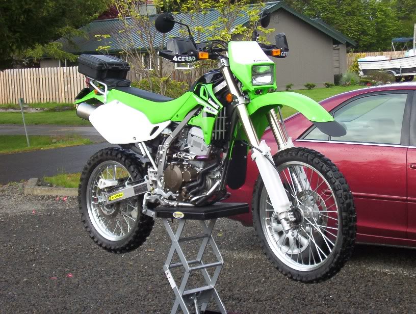

Well don't worry, part of owning a bike, is the satisfaction of being able to tinker and fix stuff. Its all part of the process. Hey what kind of bike stand do you have? Here is a picture of mine, and as you can see it has a spring hook system to go to the pegs that helps hold it in place. I know with mine if the bike is too far forward the dog bone will not let it sit flat, I just pull it back till it rests right up against the stand and its perfect.

Thanks Green242...and Deej I have an aluminum stand with rubber on the top. I got the bike up after a few trys...someone on this forum gave the tip of 'tipping' the bike on its kickstand to get it up. But, as I have learned I need to learn the trick for getting it off.
Your stand looks way better! and I think as you said, I'll learn from my mistakes and someday look back and laugh at them. But when they happen, you gotta admit, it makes you mad as hell
