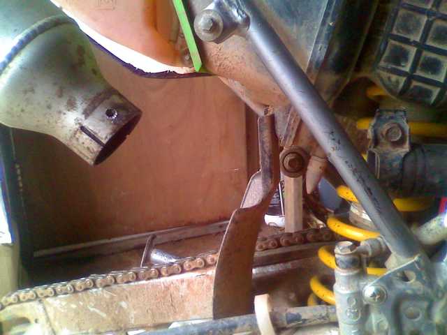

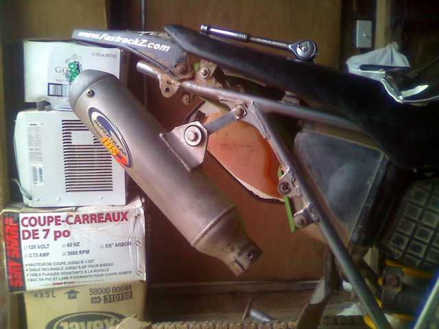

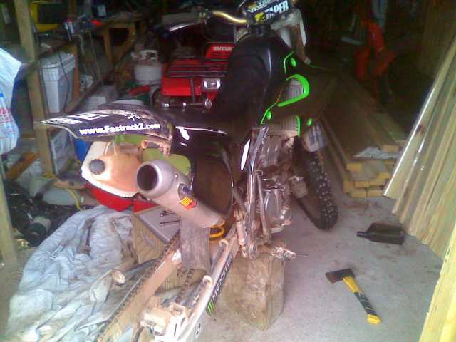

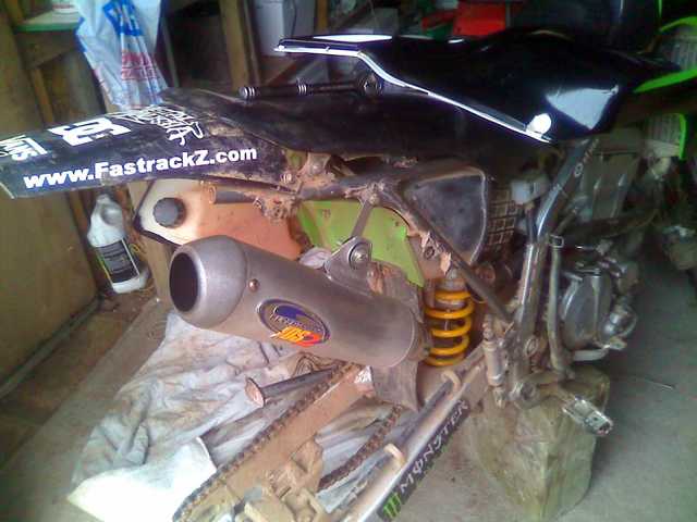

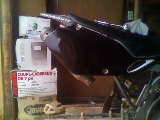

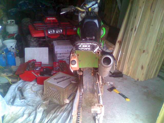

well i finally got a bit of spare time and done some fooling around with where i want the muffler to be, heres a few pics sorry about the quality... what do you guys think?
P.S. illl have it all hooked up soon hopefully within the week and ill post a sound or video clip up

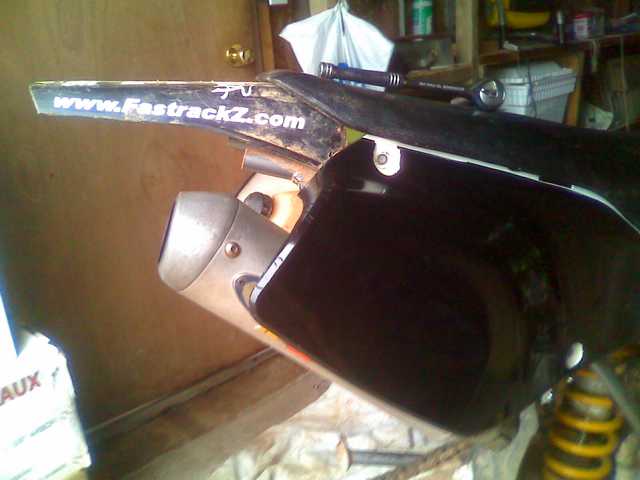

here's a couple more...

I like it. The way you have the muffler angled, you're only going to have 1 bolt holding the whole rear of the exhaust up. That's fine, but I'd make that hanger bracket a little beefier if I was you, just to be safe.

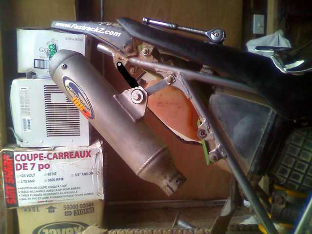

yah that only a piece of 16 gage steel all i had on hand at the time im planniong on using a piece of 1/8 steep plate once i got the right angle found im also planning on making another bracket for extra stregnth to bolt into the top bolt hole and kind of com down onto a triangle to meet with the muffler.

here's what i have planned to do with some 1/8 inch steel plate for brackets once the mid pipe is fitting good and the exhaust angle is right...
