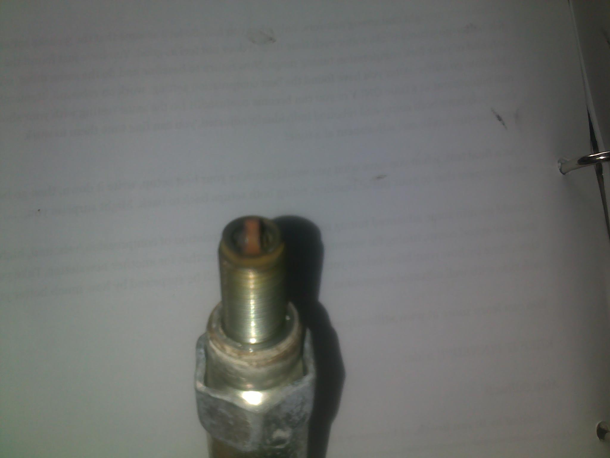

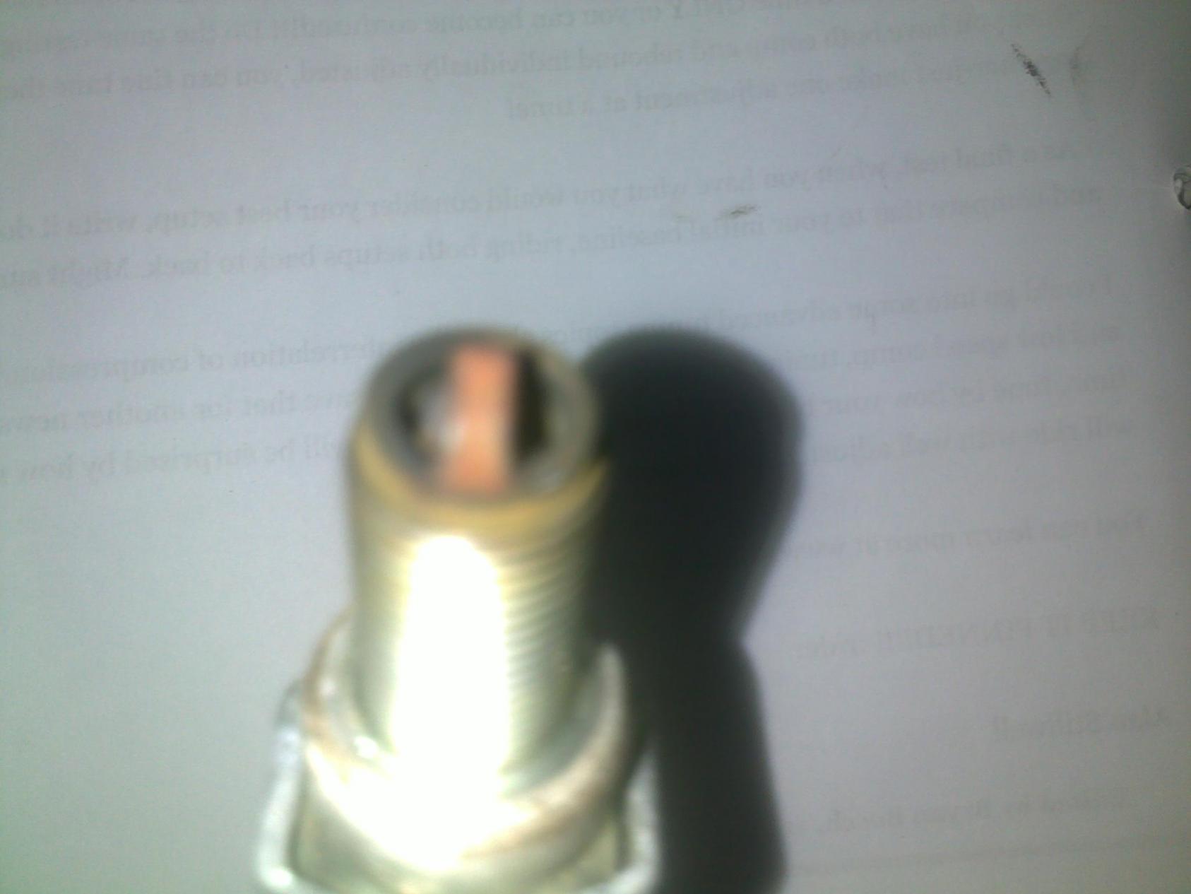

OK Guys what are you seeing from this spark plug colour?

Old Mar 2, 2012 | 08:18 AM
  #103
jeffward's Avatar
Joined: Jun 2010
Posts: 183
I think it needs more gas
