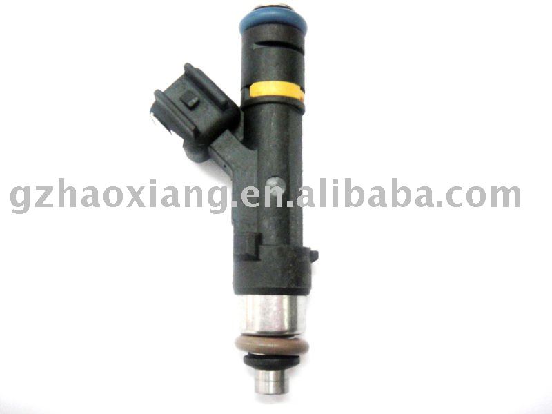

@Joel: I was looking for Beet injector at Motorcycle Parts & Accessories from Japan - Webike and i can't get a pic of the device, it is a nozzle only isn't it?
I'm not convinced you actually need it but here is a picture I took before fitting the injector.

thanks Joel, just trying to figure out what i can be doing with the injection beside the ECU.
