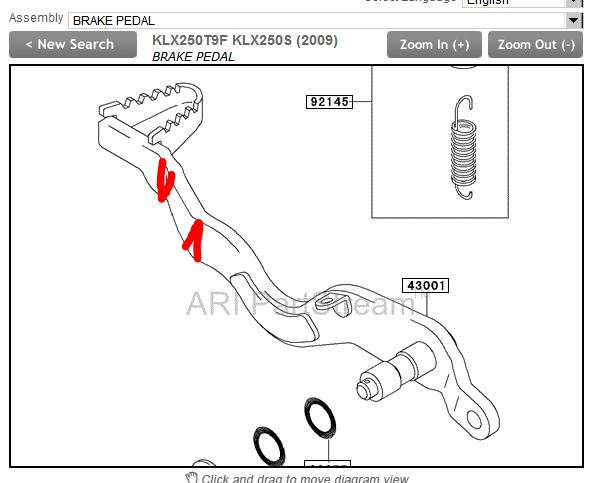

Hmmm... I'm not the only one that finds the rear brake "adjustment" lacking? I just ordered a second pedal from a seller on eBay. Paid $15 for it, shipped. I'm planning to cut a couple wedges out of it, bend the wedges closed, and weld them up. (see attached pic)
I'm trying to lower the pedal so that standing flat, I'm not applying the rear brake. Hopefully, it will work. If not, I'm out $15 and I put the original pedal back on.

rgoers, that's a good, worthwhile project. I'm sure there will some improvement. Like I said, I've never liked the bend of mine either. I also think part of the problem is the tiny throw of the linkage and small stroke of the master cylinder piston. It's annoying, but I use the front brake about 95% of the time, so I haven't gotten fired up enough to putz with it.

I'll try to document what I do and maybe take some pictures along the way. If it works out well, as I expect it to, it will be a significant improvement. Part should be here any day... if I *don't* take the sleds out this Friday, I'll probably work on the lever.
I'll post results, for the benefit of others, when it's finished.
