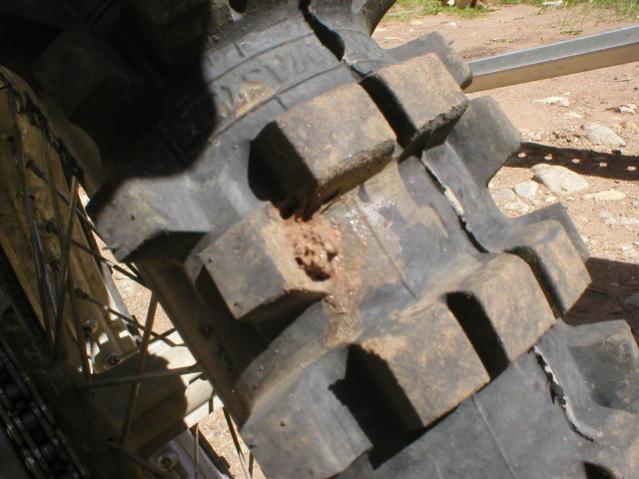

Just got back from nearly 3 weeks in southern Utah on mine. I'm now going to my 5th rear tire and 3rd front tire on my 3-year old Tubliss system with never a leak, flat, or failure. Even a large nail in Colorado didn't cause me to lose air in my rear tire...only noticed it when I was lubing the chain in camp.

But it did seem like it would be a good setup. I just couldn't really trust it after that. And since I have never actually even gotten a flat with my tube setup, I figured I would stick with what has worked for me all these years.
One thing I did fine appealing with tubliss is that if you did get a nail puncture like you did, as long as the carcass was not torn or otherwise damaged other than the puncture, it might be possible to repair it with a plug which would be very simple. But I never got that far, though. Never even got out of the driveway.

Nobrakes, that's definitely right on the use of a plug. I pulled that nail out and the Stan's tubeless sealant seemed like it would seal the nail hole. However, not wanting to risk it, I put a plug in the hole 10 minutes later...see pic. I wore that tire out with the plug in place with no problem.

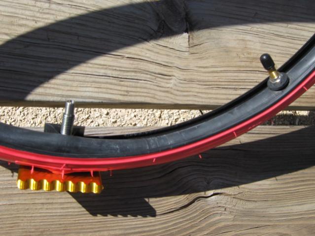

Redpillar, it comes with its own built-in rim lock attached to the hardshell.

Just a quick heads up, I forgot to mention this important detail the first go around, but I went back and edited the original post to include it.
Don't forget to periodically go back and check the torque on the rim lock nuts. They tend to work themselves loose over time. I just checked mine from a set that I did a while back and they were way loose. An overly loose rim lock is like having no rim lock at all = flat tire. Also, this reinforces the need for a torque wrench - eliminate the guesswork, make sure they are tightened the right amount.
