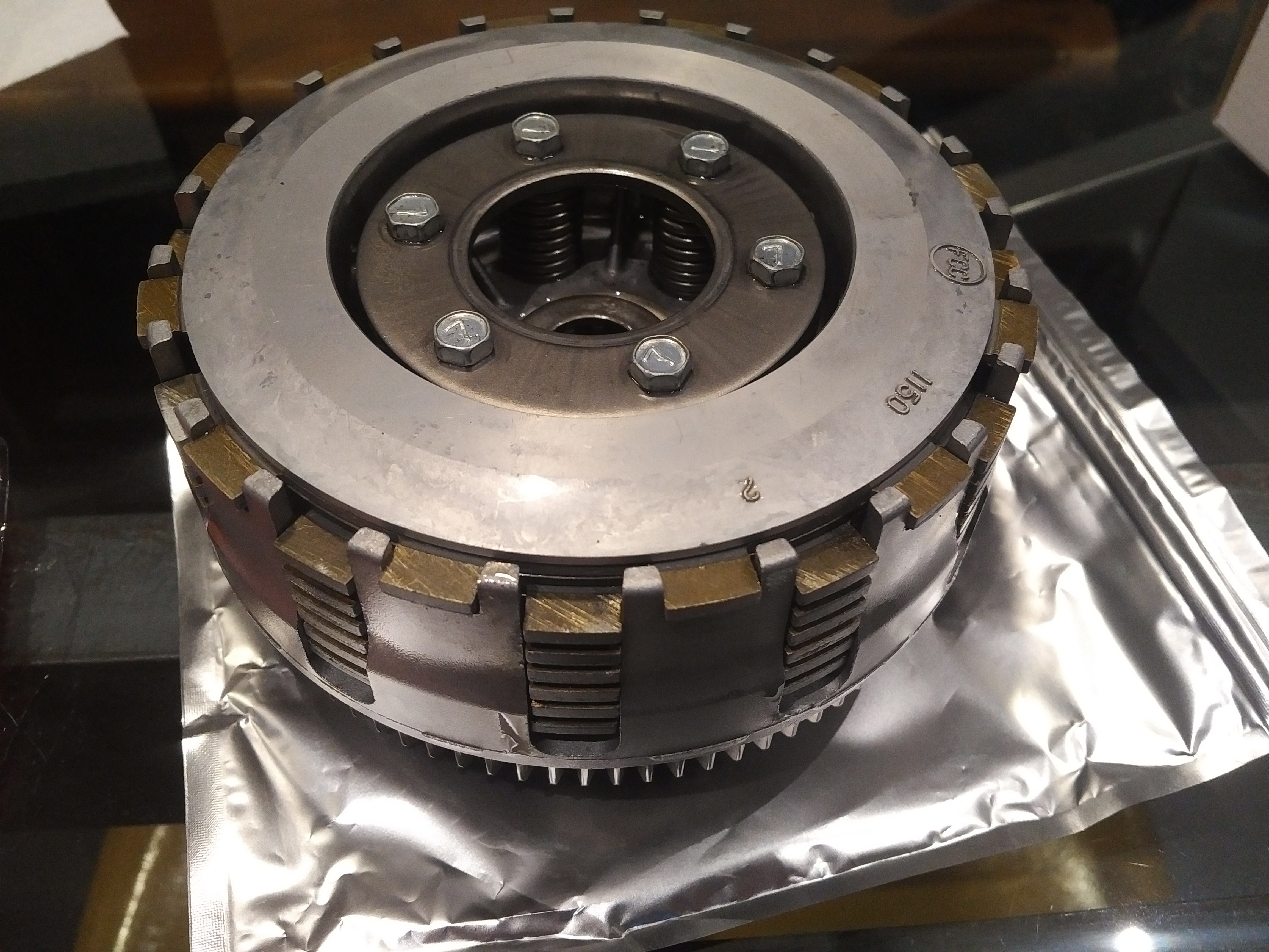

Here's the stock clutch. Notice the top friction plate sits in separate grooves. This keeps the pack lifted up so it doesn't hit the bottom of the basket.

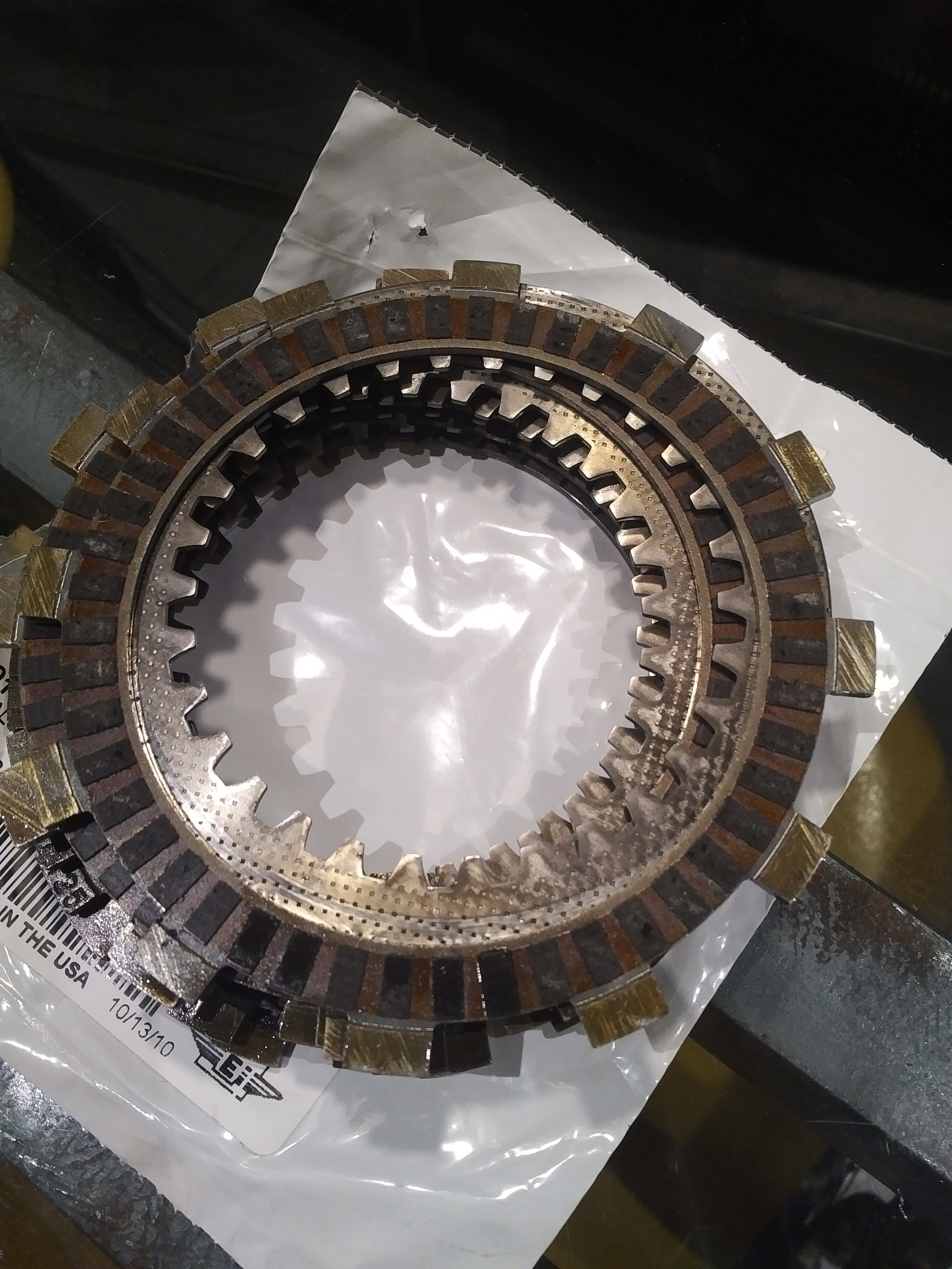

And here are the stock plates removed. Notice the dimpled surface on the plates.

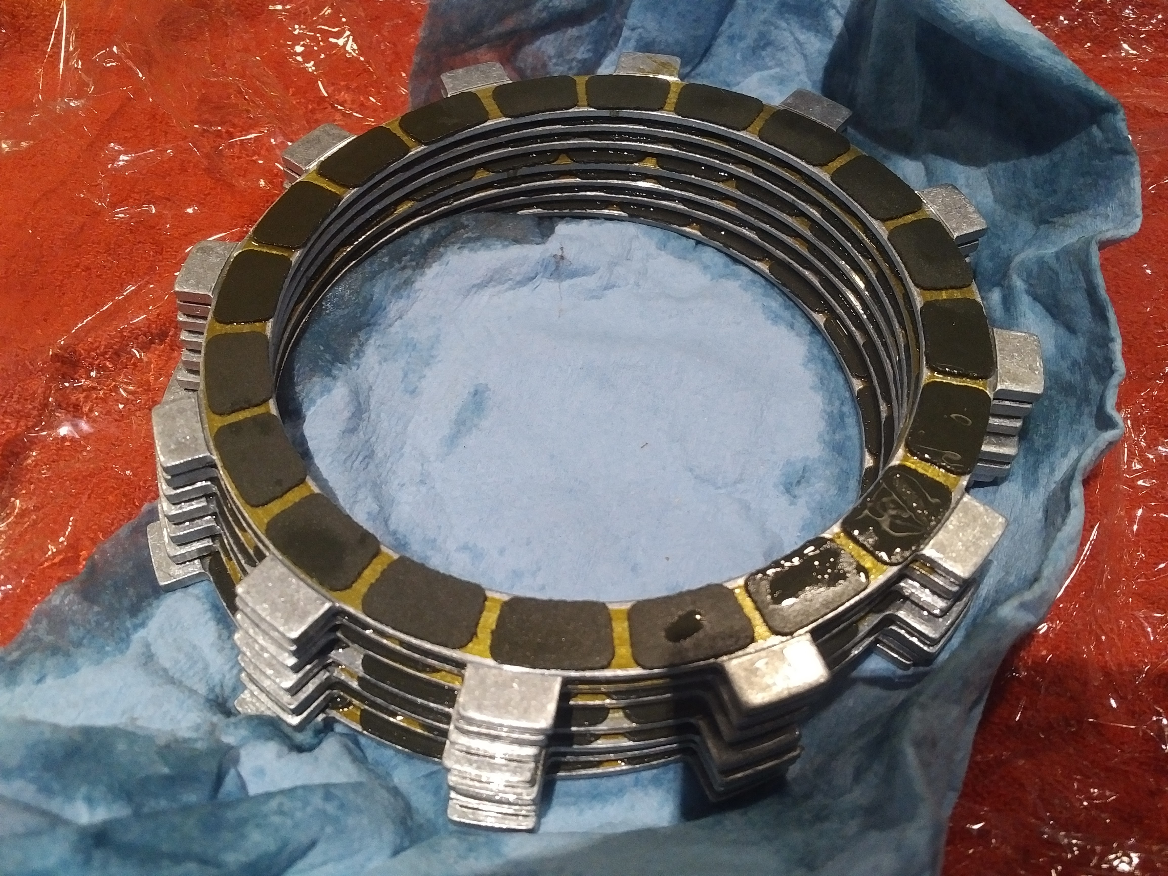

Next we have the Barnett friction plates. These have much more area than stock as the pads are larger. Per instructions, i marinated these overnight in some delicious Castrol Actevo.

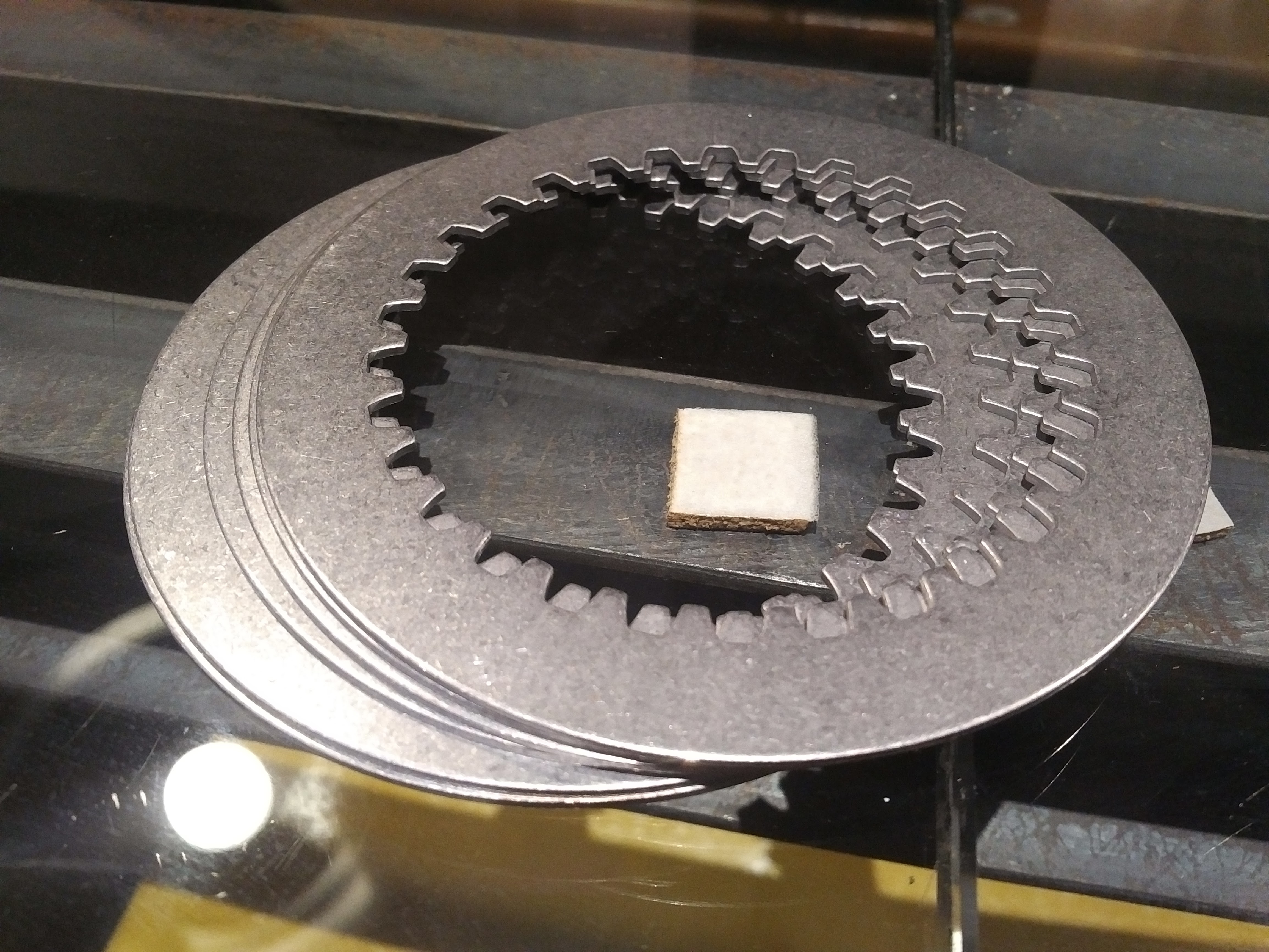

Here are the Barnett plates. Not too interesting. However, they lack the dimpled surface of the OEM plates. I wondered if this would reduce friction, as the surface is more rough on the OEM plates, or if it would increase friction, as less oil would be trapped between the friction plates and the metal plates.

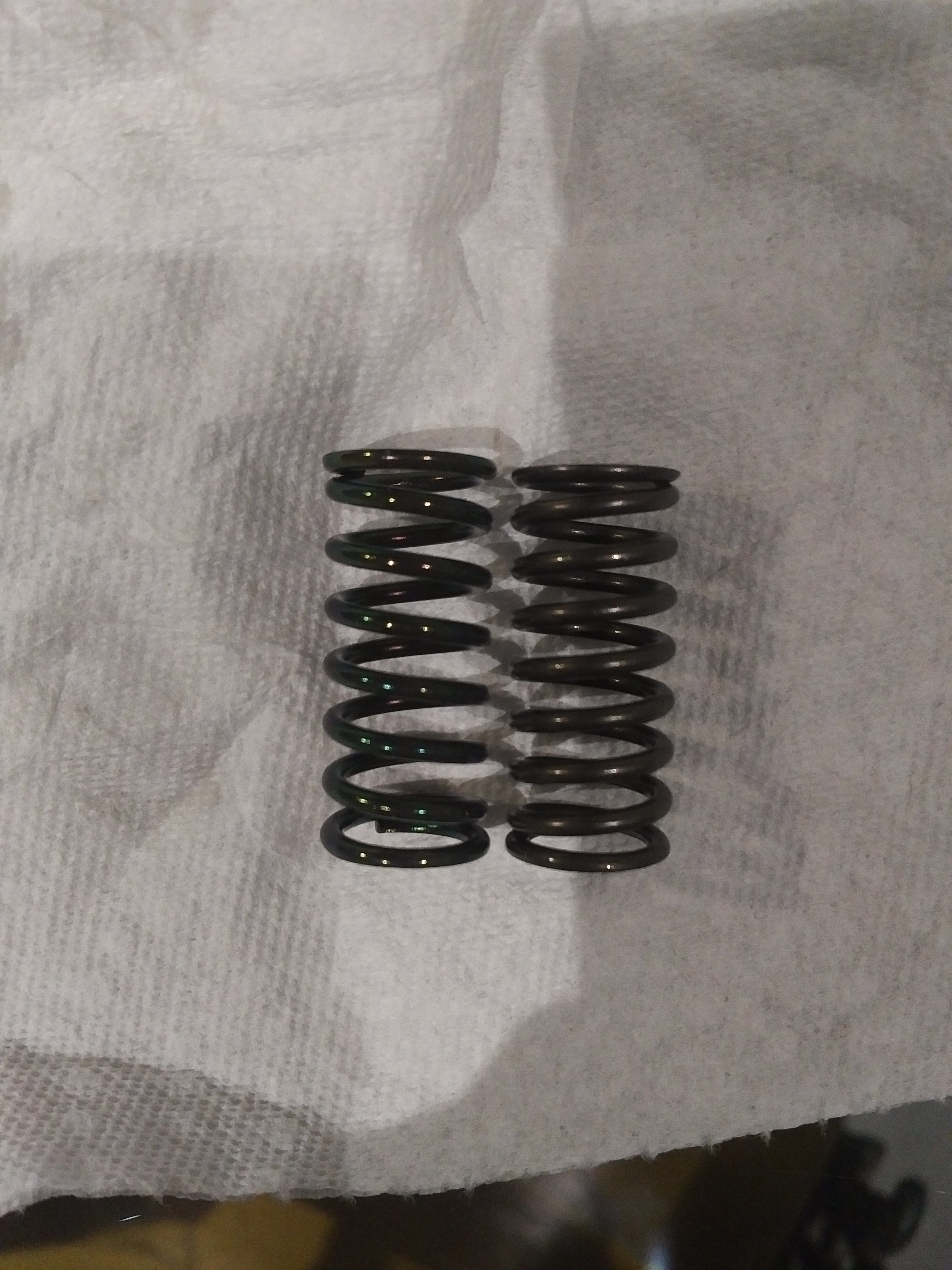

And finally we have the likely culprit: springs. Well there's the problem! The EBC springs are noticeably thinner gauge wire than the Barnett springs. This results in fewer turns (EBC = 9 vs. Barnett = 8), and a stiffer spring. Also, the Barnett springs were 1mm taller.
