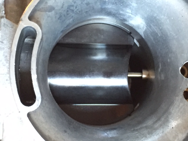

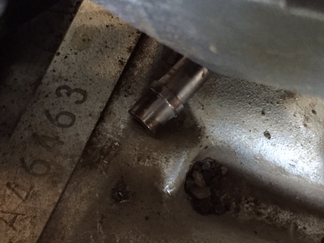

Well... I had a sneaking su****ion after reading this.....
"There is a brass "collar" sitting above the Emulsion Tube. This is the Needle Jet. It protrudes into the carb bore and it is the first item the needle slides in and out of below the slide. It will likely fall out after you remove the Emulsion Tube. If you leave it out or install it upside down, it's "game over" until you go back in and do it right."...... -Klxster, CVK34 list of issues, problems, fixes, post #14
And sure enough......
After I went ahead and removed the carb, (instead of trying to twist), there it was...I picked up my needle jet, dropped it in and re-assembled.
Now it starts AND runs past 1/4 turn, imagine that!!!! I haven't gotten out for a real ride but I putted around the property with no seat or plastic, and all seems good.

No XCR, I would have told you in a minute if I'd known that THAT was likely your problem.
I was kinda thinking that you may have gotten a "wrong" pilot jet..
Aside from not getting a diaphragm seated well once, on a members carb, I've not made any mistakes with my carb sessions - but this is only because I'm old and have been tweaking/rebuilding all kinds of carbs for 40+ years..
So, I'll make a confession - That thread I posted to help with troubleshooting - A lot of those posts were the result a mental exercise of imagining what all could possibly go wrong during a carb session.. And the Needle jet - I put that in there because I remember that once, it fell out while I was handling my carb.. I put it right back in, so not a problem for me, but I imagined that others may not be working on their carb in a "safe & secure" environment. And that a missing needle jet may go unnoticed or even un-found.. I really had no idea what symptoms you get when you leave if out - now I do.. And the symptoms are surprising..
