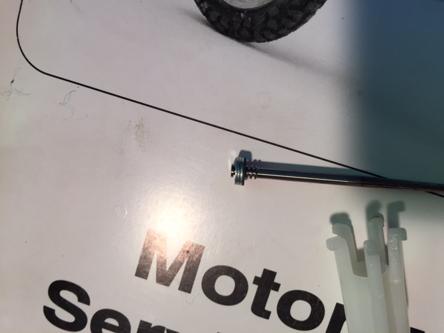

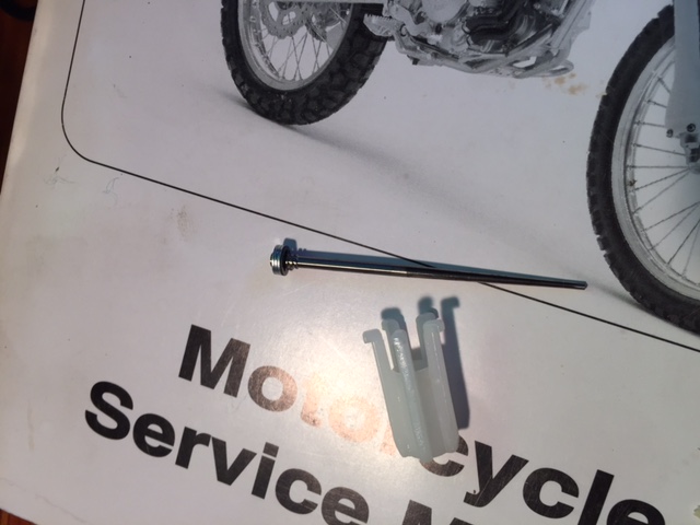

Ok, I ended up removing the tank which gave easy access to the top of the carb. I will include pictures rather than try to explain, as a lot of this carb talk still goes over my head. Let me know what you think if you will, thanks!!!!!
ETA...Im not sure the identity of this needle(stock vs DJ?) but the C clip is on the middle notch, with 3 washers stacked on top of it.
Edit#2, after looking at the pics in the "cheap mods" link in klx678 sig line, I don't think my needle is stock, the author references a n1-tc needle, that although is adjustable with notches, in the picture it has a "shoulder" that my needle does not have.

If I am able to confirm that the needle I have (pictured above) is in fact a DJ, then I should do as advised by Klxster and move the clip to the top notch and add two of my washers in addition to that, then resemble (carefully) making sure that the rubber diaphragm seats evenly and correctly.....
Then order jets from DJ....

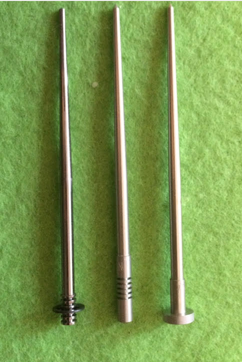

I think that's the DN0228 needle from the DJ2152 kit. I can't tell because you left all the washers on it.. It is certainly NOT the DNO352 needle from the DJ2206 kit..
So, here, you tell me.. Left to right, DN0228, N1TC, Stock..

Yes, the one on the left, the DN0228. Definitely not the other two. Has 5 notches, clip is on the middle with 3 washers stacked on top. Would you agree, topmost notch, add two washer above that and reassemble?

Yep, with a DJ140 or a K152 (Keihin) main jet, and stock slide spring, leave off the airbox lid..
However, until you get the DJ140/K152, better put it back together as is..
