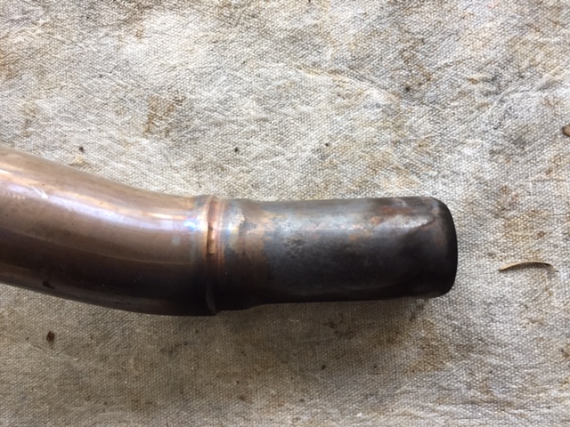

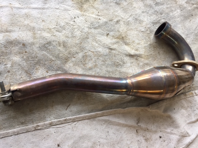

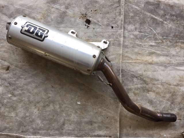

In the pictures above, you can see the purple tinge, as well as the crimped end on the FMF to fit the DG. I measured both pipes, and they both measure at 1.48 o.d...knowing that, I wonder if I could get a piece of SS with a 1.5 i.d and have it my friend weld it to the DG portion(after cutting back the bottle neck of course), and then eliminate the funky crimp on the FMF end and be good to go?

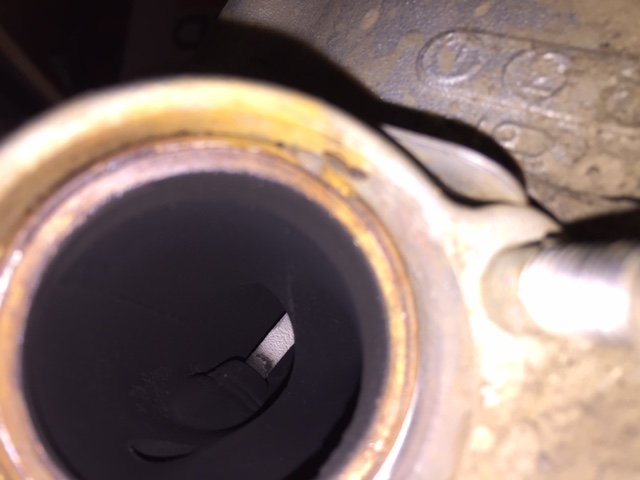

Also, the one picture is looking into the exhaust port, and I would like to know if the valve stem normally has that white lumpy build up on it?

looks like the PO did a number to that pipe. I wouldn't worry about pipe color. It's thin stainless and too rich can also make exhaust heat . If the air injection is still intact that doesn't help burning the extra fuel in the header.

Firstly, please take s10gto up on his very generous offer. This will get you "up and going" with a proper performance exhaust system. Stock header + DG will make tons of TRQ, especially with MCM added, in a lidless CVK setup.

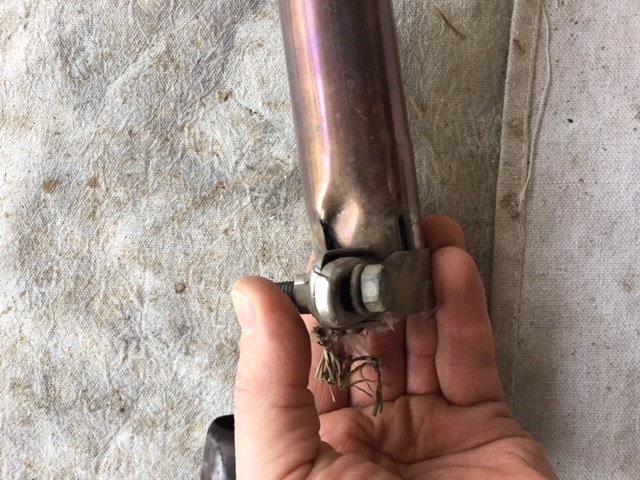

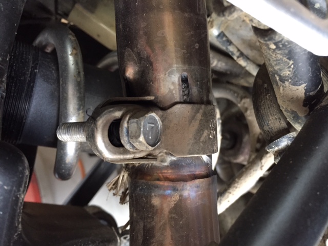

Your High Dollar Megabomb has been butchered. No doubt it could be repaired. Perhaps there is enough of the original bell left to allow a seal onto a FMF slipon. The hacksawing looks like it does not run the full length of the bell..

E.T.A...I didn't know if that valve was normal looking, but included it just in case that was a "bad sign"

The internal diameter of the DG midpipe is smaller than the FMF's midpipes.. You can verify this yourself - the FMF midpipe is "same material" as the megabomb and is same size to the megabomb "piping" just in front of the megabombs' bell. That Megabomb bell is barely identifiable as the wall thickness of the FMF stuff is "thin".. When you mate FMF to FMF, there is no "neck down" at all, at the slip joint - no impediment to gas flow at all..
You'll see that rigging up the DG to the Megabomb will still create mismatched I.D.'s - and in this case(header larger than midpipe), the mismatch is counter productive..
Just to be clear, counter productive means, IIRC, you loose power everywhere compared to stock header + DG.. Don't ask how I know..

If you still have that pipe I'd do the following
This description is actually more complicated sounding than the work actually is. It is what I've had to do to round out flattened expansion chambers in the two stroke off roading days.
Besides you already have the head pipe so it's not costing anything to play.
One other thought too. If you can get it out fairly close to round you might be able to have a muffler shop flair it to the needed size to go over the muffler (or vice versa).
And final possibility that will work... Measure how long a piece you need, get a piece of tubing that long and the right size for the slip fit, cut the bad part out of the header and weld on the step up slip fit sleeve.
May as well try, better than having the thing hanging in the rafters for ever. And it's always fun to try to fix things you didn't screw up yourself, while throwing curses on those foolish enough to try that sort of rigging. Then you can either use it or sell it on ebay for a bit of gain.
