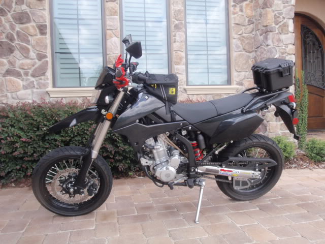

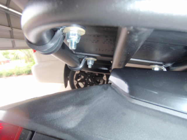

Installed the Pelican iM2075 (similar to 1300 but different placement of latches) today. I have easy access to the Nomadic rack bolts.
I used 1/4"-20 hex bolts (1” in length). I originally had 1.5” bolts and they were way too long. So I removed all the bolts and re-attached them with the shorter ones. Much better.
I also used rubber insulated clamps that I got from Home Depot (Calterm # 67793, 3/4" diameter) along with some washers and lock nuts.
Stats for the iM2075 are here: Pelican*Products*iM2075*Pelican Storm Case
I purchased mine from here: pelican cases for laptops + camera cases + shipping containers from Pelican-Case.com and would recommend them. Decent prices and really quick shipment. (I have no affiliation with them.)
A couple of pictures I took. I will comment, in person the case does not seem or look as high as in the picture. Also, I have no problem swinging my leg over the bike.

That looks very well done, looks like the clamps worked out perfectly, looks very secure.
