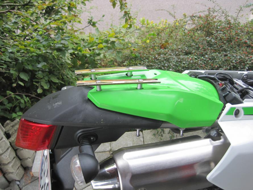

I’m looking into adding a Pelican case (either 1300 or 1400, can’t decide) to the Nomadic rack on my 250SF.
One thing that might present a “challenge” is the bolts used to secure the Nomadic rack. They stick up quite a bit.
Has anyone installed a Pelican case on a Nomadic rack?
If so, what did you do?
Pix here:

It can certainly be done.
First, as you said, the bolts stick up a bit too much, but not as bad as you think.
You need to grind down the collars they are going though so that they sit down about a bolthead thickness lower.
Then what I did was weld nuts to the rack, then used large wingnut headed bolts that I could screw in by hand, they ran down thew the pelican case threading into the nuts on the rack. You can also use eyebolts.
As you can see I used 3 attachment points, I would suggest using 4.
I used a Pelican 1450 Case.
If you dont ahve a welder, another way you can do it is to use U bolts, that will clamp onto the rack and bolt up through the bottom of the case.
I didnt even bother trying to seal any of the holes, and never noticed any water getting inside.
I have heard this isnt good for the sub-frame with alot of weight on a rack like this, but I never noticed any issues, but it wasnt on there all that many miles either. If you plan to have a good bit of weight in it, you might want to gusset the sub-frame in the back.
Hope this helps, let me know if you have any questions.

Hmm - why not utilise those two nuts instead oif fighting them ?
Remove them and replace them with two longer bolts - and mount them from below (up side down). Then drill two holes in your case to match the upstickng bolts and put a washer and a not on them - from inside the care.
Then You just need 1 more mounting point to the rear.
Btw - why bother with a rack if you just want it for a case like that ?

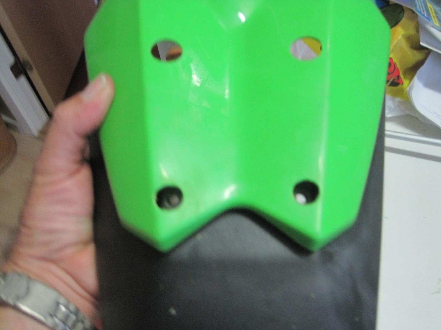

I mounted my topcase without any rack;
Attachment 4525
Note the two extra holes - has to be directly over the rear frames mounting point for the rear fender.
Attachment 4526
The two bars was part of the mounting hardware from the topbox I bought.
Then it was just a matter of mounting the base plate for the box and I was done:
And I even got a rear rack out of it - I can just take off the box and use the mount plate as a samll rack ;o)

Not my day as to attaching pics....anyway - here's # 1
Old Aug 14, 2011 | 01:14 PM
Jesper Hedegaard's Avatar
Joined: Nov 2010
Posts: 22
From: Copenhagen, Denmark
....and here's # 2.
Oh - I forgot; used 10mm alloy pipe to cut distance tubes from - thereby raising the mounting bars over the rear fender.
