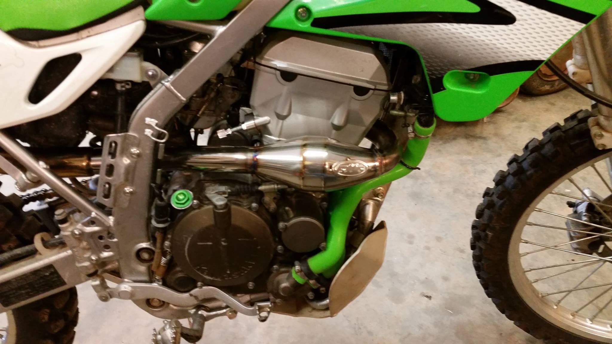

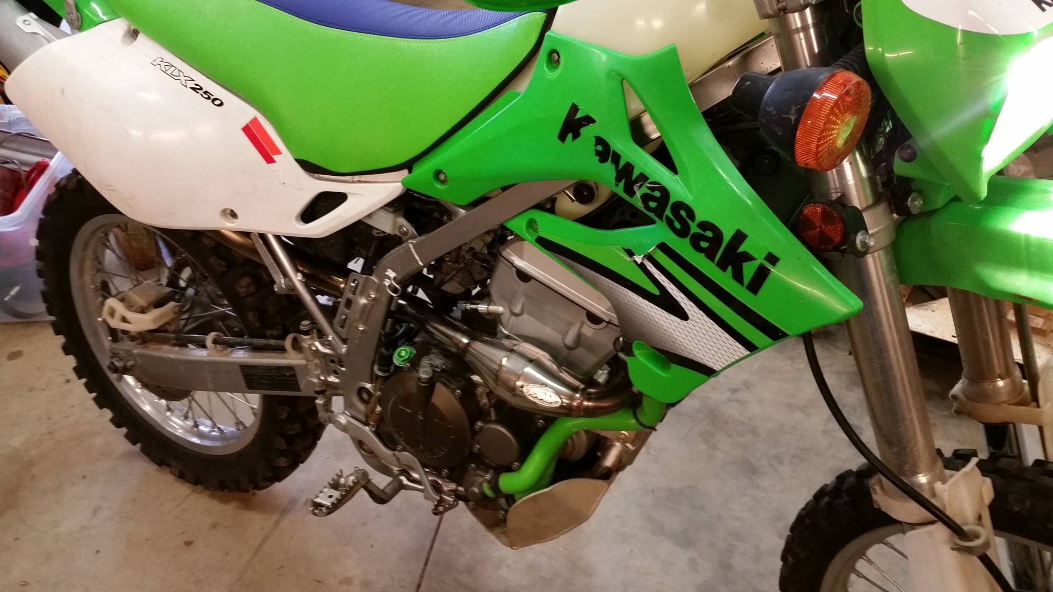

Installed the new MegaBomb today and like the looks. Better yet, it quietened down the exhaust town noticeably.
A quick check with a manual micrometer showed that the FMF MegaBomb header is about 1/8" wider in diameter than the heavier steel OEM unit.

Got some bad news for you QOS. That's a Megabomb - if you really had your heart set on a PowerBomb, I'll trade you my PB for it.. LOL
You're now a CVK setup away from "state of the art" top end power.. toss in the MCM for "state of the art" overall power curves.. It's like getting a whole new bike - just ask Steff (Steffaroo83) - she just completed the final "piece of the puzzle" (the MCM) on her '07 and spend a day in the sand with it...

I ordered what I meant to - got the name backwards. lol.
It's quieter now, love it.

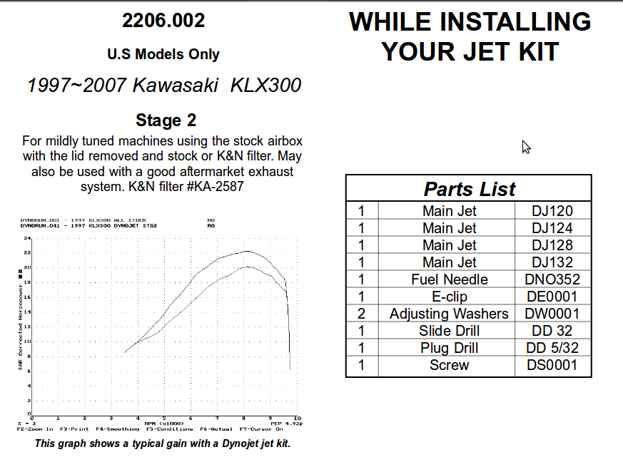

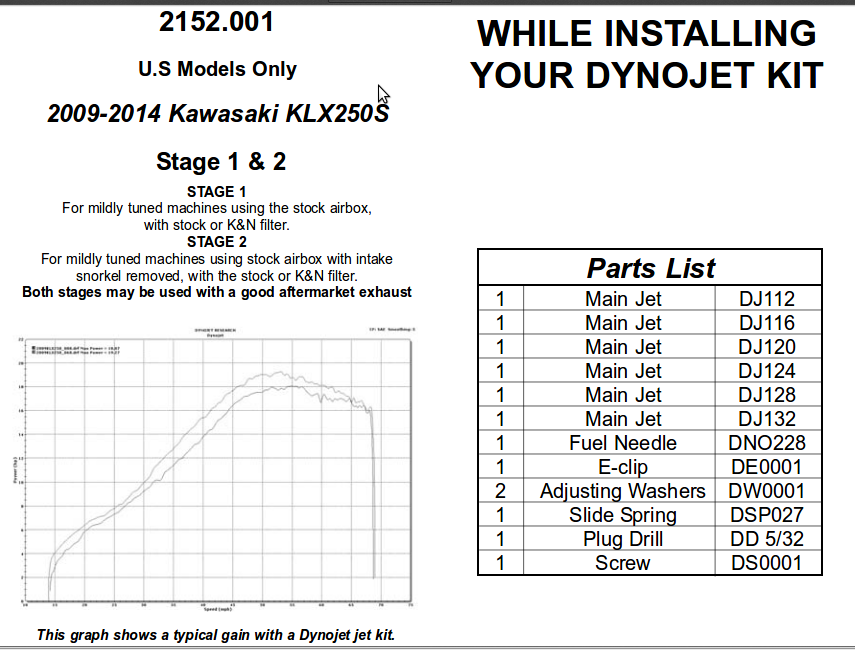

I'm at 5000 ft (Atlanta GA)
I have the 2152 Dynojet Jet Kit installed with the 128 main. K&N filter. I tried running without the airbox cover, liked the power but hated the noise (personal pref). Have the KDX snorkel installed as a compromise. All the smog garbage is gone, too.
Also, why is the OEM carb spring better than the one DJ includes?
EDIT: reading your post from last year, I think I got the wrong jet kit. :/
2152 kit listing:
2206 kit listing:

Ok then. With lid on - Snorkel or not - you don't need my advice. You just stick to the DJ instructions for the 2152 kit. Perhaps call DJ for jet choice @ 5K ASL..
The 2206 kit is designed to run lidless on a KLX300R - to use it on our KLX250's requires a modified install procedure..
Stock spring vs DJ spring is, likewise, not a subject that applies to your bike.
