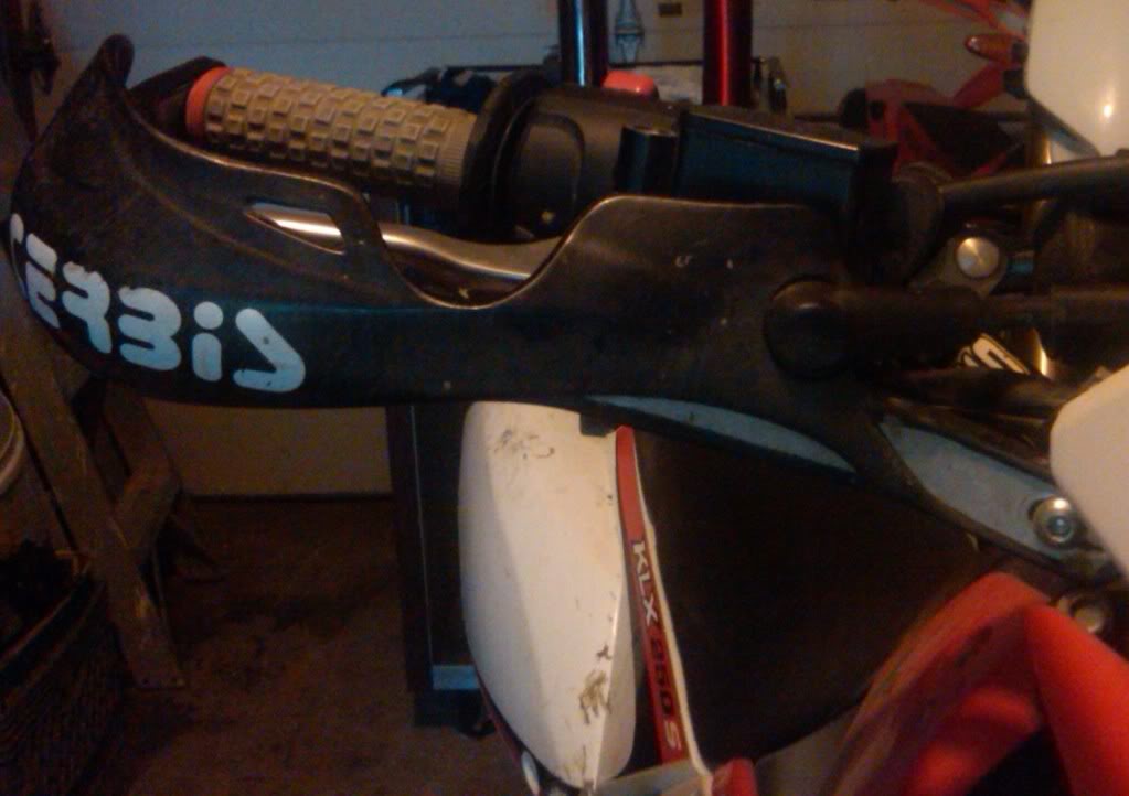

this is what i did to make the Acerbis fit nice and my brake lever work right.
I also cut the ball end from the lever to get it nice and close for one finger pull action. Notice the circle cut out with a 1" hole saw to allow the brake line clearance:
