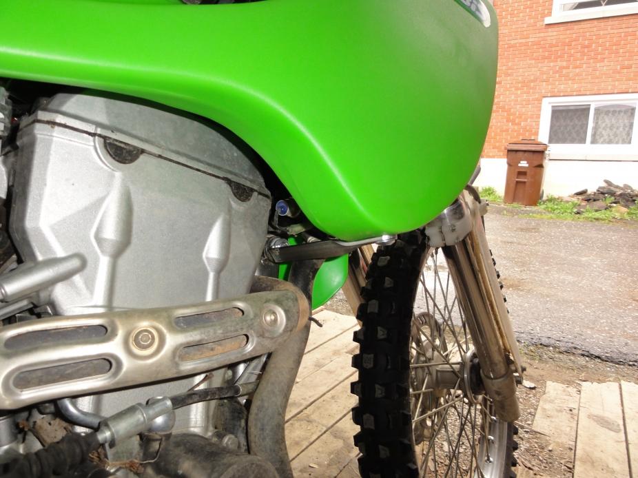

There's 2 L bracket that goes under the wing and attach close to the radiator.
Old Jan 30, 2013 | 11:40 AM
doum's Avatar
Joined: Nov 2007
Posts: 235
From: QC, Canada
You can see one here:
There's more in this thread:
https://www.kawasakiforums.com/forum...s-tanks-35194/

Hopefully, I should be able to fabricate new brackets. I guess I'll just have to figure out what size bolts/screws fit in the holes in the bottom of the tank.

Mine didn't come with the brackets either, so I fabbed them too. It was easy. BUT... in my case at least, I need to get longer bolts for the front motor mount, since that's where I'ce been connecting the bracket too. One side is fine, but there aren't enough threads left on the bolt to hook 'em both up.
