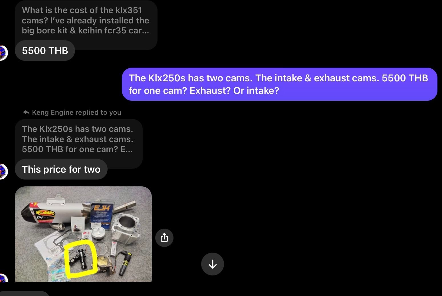

According to Keng Engine gears are same!

Camshafts article with all the KLX300R(2020+) and KLX250/300 specs - https://planetklx2.netlify.app/docs/engine/camshafts/
@RaceGass you've been correct - Keng cams are not KLX300R cams. Their base (how they are attached to timing gear) is the same as in KLX250 and different from KLX300R.

@RaceGass you've been correct - Keng cams are not KLX300R cams. Their base (how they are attached to timing gear is the same in KLX250 and different from KLX300R)
And video comparison:
https://youtu.be/FkBhQYaSjA4
Thanks for clearing up the cam manufacturer question. The cam gears being different helps make the decision to go with Kengs cams an easy one, price wise also.
