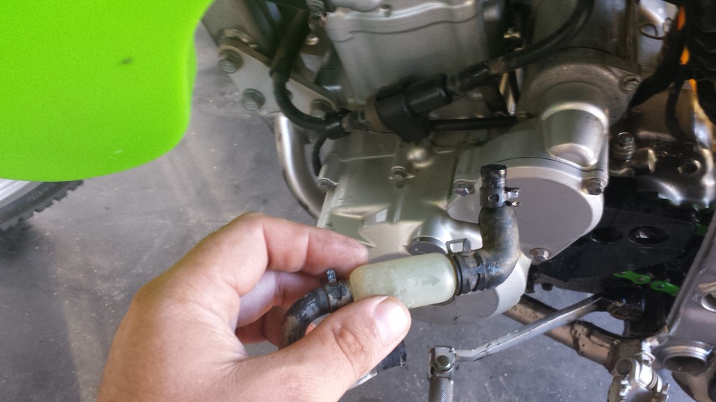

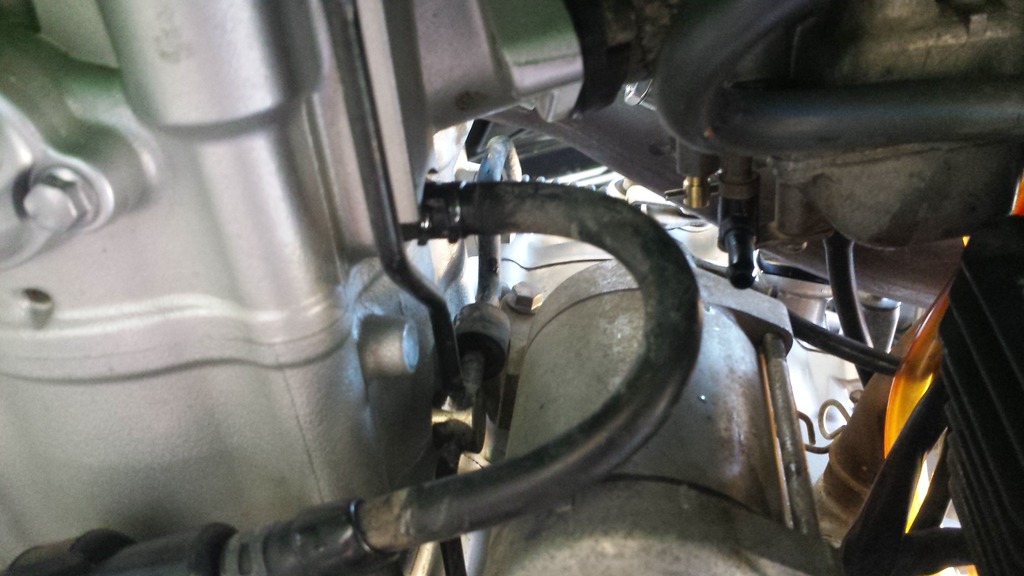

I managed to relocate and remove some of the coolant hoses going to the carb. Now I get full access to the Kouba screw and can turn it through full range of motion. As I tick off my list of stuff to do, I've found something else, My stock bars are bent so the Pro Taper bar I have lying around is going on tomorrow.
