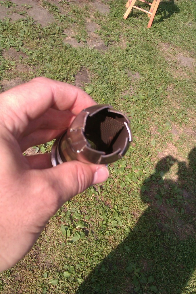

I messed with the spark arrestor a bit too. I found the Q4 to be way to loud to my taste. The 1 1/8" quiet core being around 40$, I tried to tamper the sound with what I had around the house, an angle grinder and some pliers to reduce the "stock" spark arrestor diameter.
Here is the result:
It worked.

Nice. Is that the "in" or "out" end of the spark arrestor?
Old Sep 12, 2012 | 12:56 AM
  #45
DustyCowboy's Avatar
Joined: Aug 2012
Posts: 127
From: Canada
The end that goes in the pipe...
