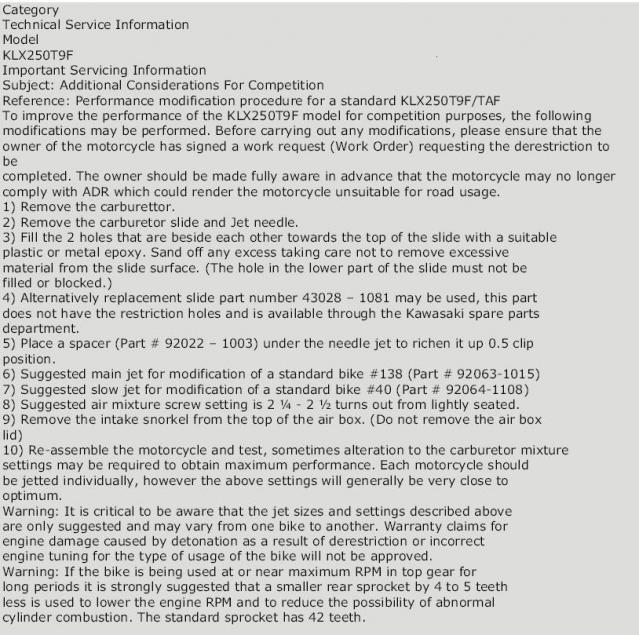

Hi Mate, I have just done the pipe FMF Q4 and kept the header which works will, did the jetting with Dyno Stage 2 and K&N air filter and removed the snorkel on my 2012. I got everything from the US delivered at $450 using motorcross giant and ebay. That is less than the price of a slip on pipe in Oz. There is a de-restriction of our bikes, essentially, the main jet goes from 132 to 138, Pilot goes to 40, and the two holes at the top of the carby slide are either filled in or replaced with a new slide that has not holes. Apparently, this makes a world of difference. I have hopefully attached what I was sent by KLX4Me, Mine didn't get the de-restriction and is going in this week. I learnt the hard way and already paid for the Dyno Jet kit and installation which will probably be a waste of money now. But anyway, just be careful when reading about the things done to bikes on the forum as the US and AU bikes are somewhat different. This is a great place to read about the bike. Good luck.

The power on any motor has 3 elements and really to reach the full potential need to be done together. Air in, exhaust out and more fuel. You have taken care of the exhaust out, but added no more fuel or air in yet. Trust me, jetting and opening up the airbox up some will be the difference between night and day.
