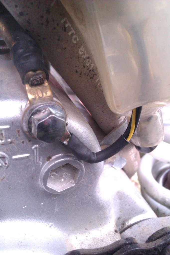

Originally Posted by Lotrat
There is a grounding mod to fix the stumble at 6500 rpm which I'm about to do. I'd make sure its not your carb causing it first. My bike has always had it, just getting annoying a year later.
you haven't regrounded the wire yet? it's really easy, i havnet hiccuped on this new 09 i got... yet

Thank you for the help guys! ;-)
I've already put a new plug in when I did the oil change.
I don't know how I missed it when I did my research concerning the hiccup, but here is the ground mod done on my bike 30 minutes ago.
There's still a lot of parts to be bought for the bike, including a skid plate, some hand guards, a bigger tank and a rear rack just to name a few.
I'll try the bike tomorrow if I can find some time and report back to give you updates about the ground mod.
Originally Posted by DustyCowboy
...here is the ground mod done on my bike 30 minutes ago.
OK OK, you guys shamed me into doing the ground mod. Seems to have fixed it, but I just took a short ride. I'll know this weekend for sure. Thanks for the push.
