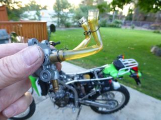

I had the same thing when I got my KLX last July. I would run out of fuel in the on position, but run okay on reserve, The problem was the previous owner had the fuel lines kinked under the tank. They make such a sharp 90 degree bend that routing and length are critical. I replaced the kinked lines with good quality rubber fuel line. NOTE: After reviewing a parts diagram, it shows the OEM "on" fuel line is pre-formed. I made my own, but I did test fit and alter it several times before getting it just right. Good luck!

1/4" 90 degree vacuum fitting:
Around a buck!
I didn't need clamps either.
