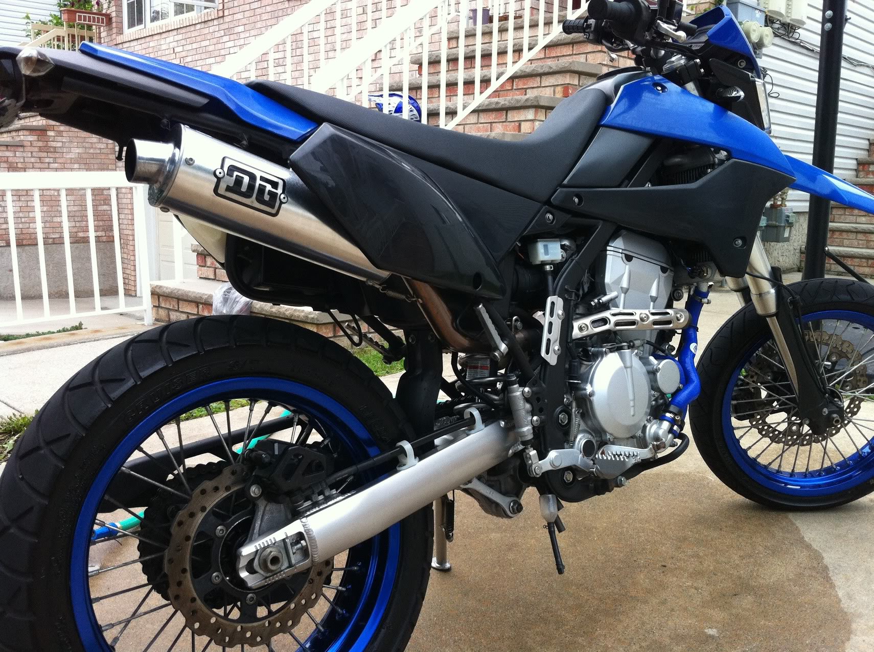

I just purchased a 2010 KLX250sf with 5k miles, fender eliminator, carbon turn signal, DG exhaust and a terrible sticker kit on it lol. I paid $3,000 for the bike, their isnt any noticable damage on the bike, and the motor looks very clean.

Quote "Is it normal for the small white tank under the rear fender to be dead empty?"no it isn't, it should be half full with coolant, have you checked the coolant level in the radiator?

Hi, good to welcome another SuMo SF to the forum. I'll have a go at answering a couple of question......Remember it's all there to see if you use the search bar effectively.
There should always be at least 2 inches of coolant mix in the overflow bottle. Wouldn't hurt to drop the coolant from your rads & replace with a 50/50 pre-mix & pop in a new thermostat, a good thing to do with any new secondhand bike purchase.
BTW It looks terrible from behind....a white plastic bottle with fluid sploshing around!! I painted mine matt black & left the inside panel (facing the wheel) clear for inspection purposes....visually looks 100% better from behind now
IMO the SF is a little bit under powered for road riding without a big bore kit.....great off-roader but dubious SuperMoto in stock form!!
The stock suspension is way to soft for a real SuMo bike.....front end dives like crazy under hard braking & the whole suspension spring package reminds me of being on a rocking horse!!
The front & rear springs can be replaced & clicker settings can be hardened with good results.....some links below:

BTW if your ordering parts from Asia/Japan for your bike it's called a D-TrackerX or a DTx250....apart from EFi instead of a carb, the SF is identical.

Was the purchase price fair ? I payed 3.7k for mine with 8000 miles on it, 100% stock though
Is it normal for the small white tank under the rear fender to be dead empty? That's bad
Is 5k miles alot for this 2010 engine ? Expect 20k+ from what I read
Is a DG exhaust respectable and quality ?One of the first mods I did, sounds great, I like it a lot on mine
What should i inspect on this used bike ?Sprockets, chain, tires, brakes, clutch cable.
What immediate maintenance should i perform on this bike ? OIL!
What are common problems/ issues with this year & model ? I'm not knowledgeable enough to know this answer
Is this bike considered a SuperMoto ? Some say yes, some say no, I say it has 17" rims, its a sumo
Is this bike respected by others being that it is only a 250cc ? For what it is, it's great, most sumo guys won't give you **** for a 250, but I ran with a modded drz400 today, when he wanted to, he could out pull me with ease
Where can i buy a graphics/sticker kit for this bike ? No clue
What type of gas grade should i use ? It says 91, I use 89
What type of oil should i use ? Whatever you can afford, changing more often is more important and than expensive oils imho
Can i raise the rear suspension spring up/higher ? no clue
What is the best product for shining and cleaning up the plastics? Windex?
What is the best way to remove the graphics kit stickers that are currently on ? I want to say hairdryer and patience, but i may be wrong
