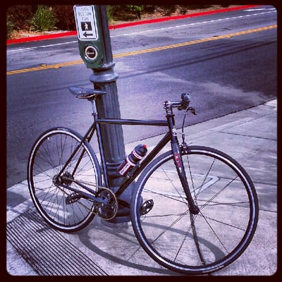

both...flip flop hub rear wheel...fixed on one side...freewheel on the other side...for the long ride, it was on the freewheel because there are some super long and extremely fast downhills...after going over the golden gate bridge from sf...it's a long drop down to sausalito...can carve down faster than most cars...i built this bike piece by piece from scratch...custom selected every nut, fork, wheels, etc...

Now THAT ^ is a sweet ride.
