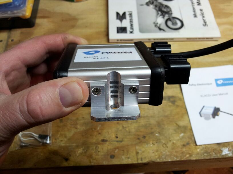

Just got the new cdi.
Great job Ray!
Product is top notch! Service and shipping as well.
Cost me about $290 with the pclink and shipping.
Comes with simple directions and everything need to mount it, including new screws and ties for the pigtail wires. Has nice added solid mounts, and looks water tight.

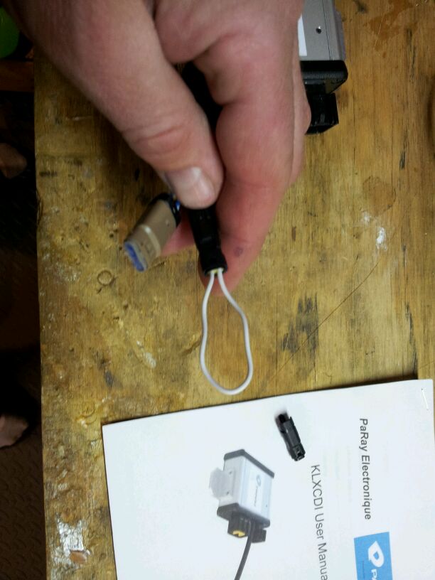

To change from 25* stock map to 35* aussie map is done by adding a short looped wire to the one pigtail. Stock map you just keep the dummy plug on it to keep out dirt.

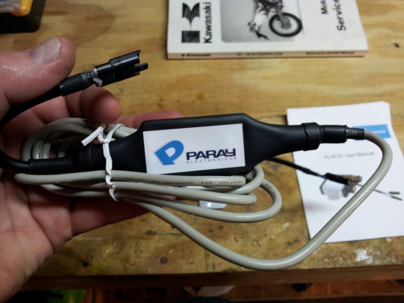

I also added the pclink for custom mapping. That pigtail wire on the cdi also has a dummy plug to keep dirt out, so the cdi looks pretty durable to dirt and water.
Gonna try out the 35* map first, will get back with results after.
When the weather finally breaks taking to dyno again to play with different maps, see if I can get 35hp?
