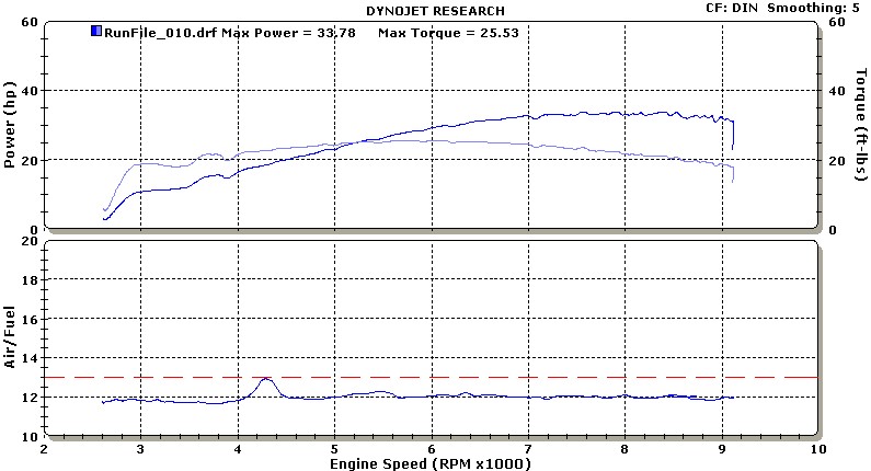

I broke the bike in on the dyno using his method http://mototuneusa.com/break_in_secrets.htm
After the breakin we ran 3 dyno runs up to 9000 rpm. I dropped the oil and ran 3 more, after the oil change it made a 1/2hp gain and was still making more at the last run which was the best. The jetting is on but probably could gain some more with a 140 amin jet. I kepted it alittle rich to be safe.

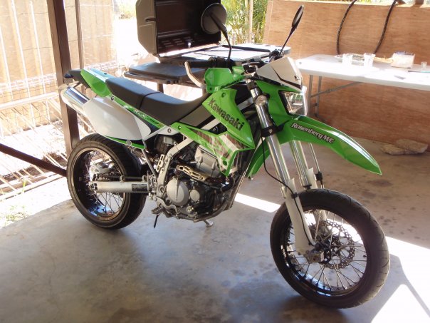

Here are some pixs and dyno sheets. The first dyno sheet is the first 3 runs combined, the next is the last three runs and the last is the best run by itself.
I guess I am totally motarded now?
AND LOVE IT!!!!
Attached Thumbnails My project 351 SM with pix and dyno #'s-klx-exhaust-side.jpg   My project 351 SM with pix and dyno #'s-bills-best-run.jpg

hehe, I had that piston in my hand one time and looked at it, it just looks like grey paint, but it sure seems to work. Good job. I wish I had the seat also. It appears the port job helps.
For comparo, my bike with stock pipe and carb, free mods, 40 pilot, 132.5 main, DJ needle full lean, airbox lid on and KDX snorkle makes 18.7 Ft Lbs torque.
Don't you just love that flat torque curve. Power all the time.

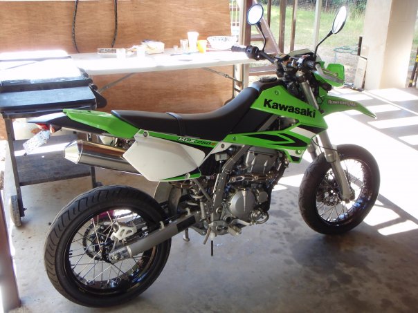

Thus far, just done the
  • Handlebars - Protapers with Barkbuster
  • Wheels (Front) - 3.5x17 with 110/70 Rubber (Bridgestone BattleAx)
  • Wheels (Back) - 5.0x17 with 130/70 Rubber (Bridgestone BattleAx)
  • Tail light - DRC Edge 2.
  • Exhaust - Staintune
Got a trailtech vapor speedo to go on to negate the change in front wheel circumference. Just got find some time to mount it.
Just using a GPS for now.
Although thinking about it. there must be away to change the 09 Electronic speedo, probably a different resistor or something on the main computer board, since they sell a SM version in the states.
Attached Thumbnails My project 351 SM with pix and dyno #'s-4668_183354495036_699135036_7181423_257066_n.jpg   My project 351 SM with pix and dyno #'s-4668_183354520036_699135036_7181424_929482_n.jpg
