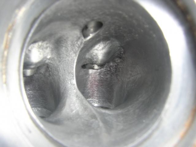

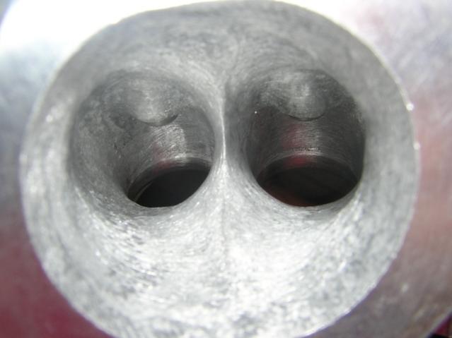

You interested in porting a florida cracker head with the same cam and piston?
Want them to look like this?
He he.
Attached Thumbnails My project 351 SM with pix and dyno #'s-ported-intake-port.jpg   My project 351 SM with pix and dyno #'s-polished-exhaust-port.jpg
Old Jun 14, 2009 | 04:21 PM
Yup, if it will get me a dyno close to yours.....I wonder how the FCR will do.
What performance gains are really to be had with the ceramic coatings?? Real World on a little motor like this.
Edit: You may want to ask John if it is ok to post those ported head pics ..... sometimes those porting people want to be secretive about that stuff.

I think the carbs will be close to the same on the dyno? Maybe on the trail could be different. I know the throttle response and quick revs are great!
As far as the ceramic coatings, I feel ever little bit adds up? The piston coating may not improve performance, but it has to help with durability. The exhaust coatings help with scavanging and keeps the heat of your leg and motor. It seems to work pretty good for me?
I talked with John before I started posting so everything is good, he doesn't seem to be like that type of person. I have dealt with people like that before, just in it for the glory & $$$, not here to help the average joe. John's here to help!
