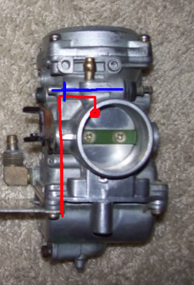

Edit: I doubt the enrichener will be the issue, but let's think about it... If you try to plug it do it like Richard has mentioned, in the throat at the butterfly. Otherwise, if it is actually causing the issue it will possibly either draw only fuel if air inlet is blocked, or only air if blocked at the float bowl. Of course that may show in the performance too.
It is such a simple device you should see evidence of damage if you simply pull the plunger out and look at it. It is a simple piston with a rubber (Viton) seal that plugs up the passage. The spring is stiff enough and I'm thinking if there is vacuum it would suck it down tighter, so not likely unless there is clearly something in there holding it open or some damage that should be seen.
If I understand how to functions correctly, the plunger prevents a vacuum - caused by air passing through the carb. When the plunger is pulled out it allows a vacuum to pull fuel from the bowl. If there is a rubber seal at the end of this plunger and it's leaking, it would allow air to be drawn up (highlighted in red) and engage the enricher circuit. The predominate forces should be working to pull the plunger out if anything.
https://i.imgur.com/c9bNHuu.png
Mid Range Sputter / Misfire - Input welcome-c9bnhuu.png
http://web.ncf.ca/ag136/cvCarb.jpg
