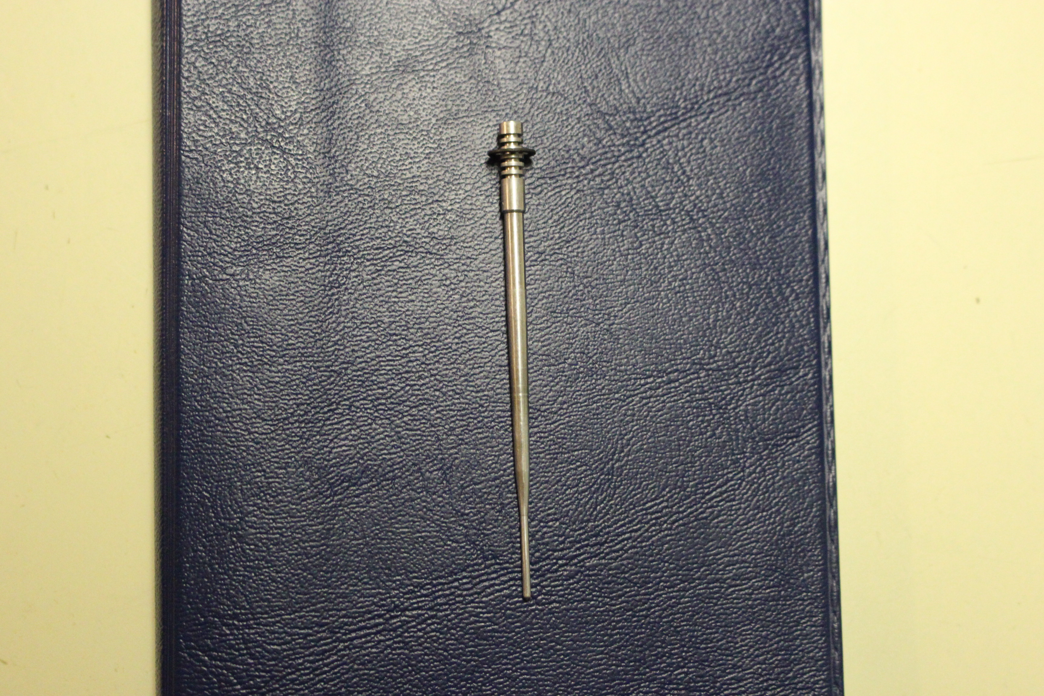

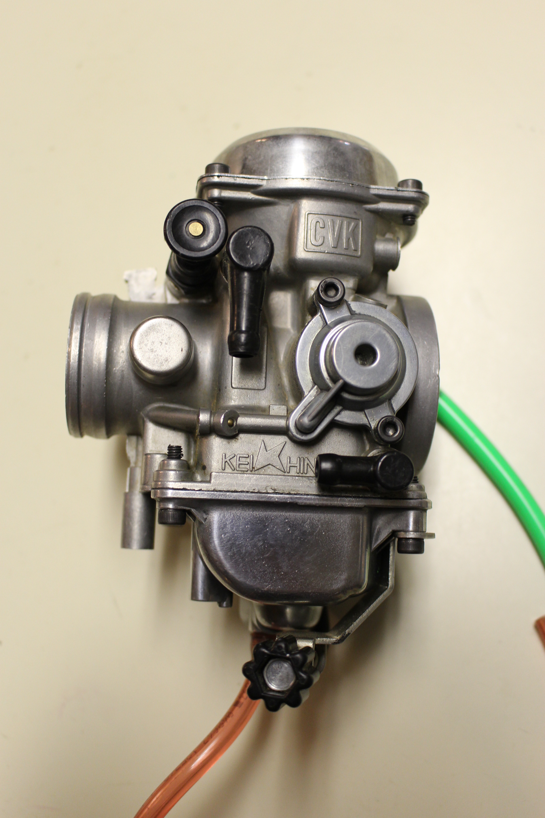

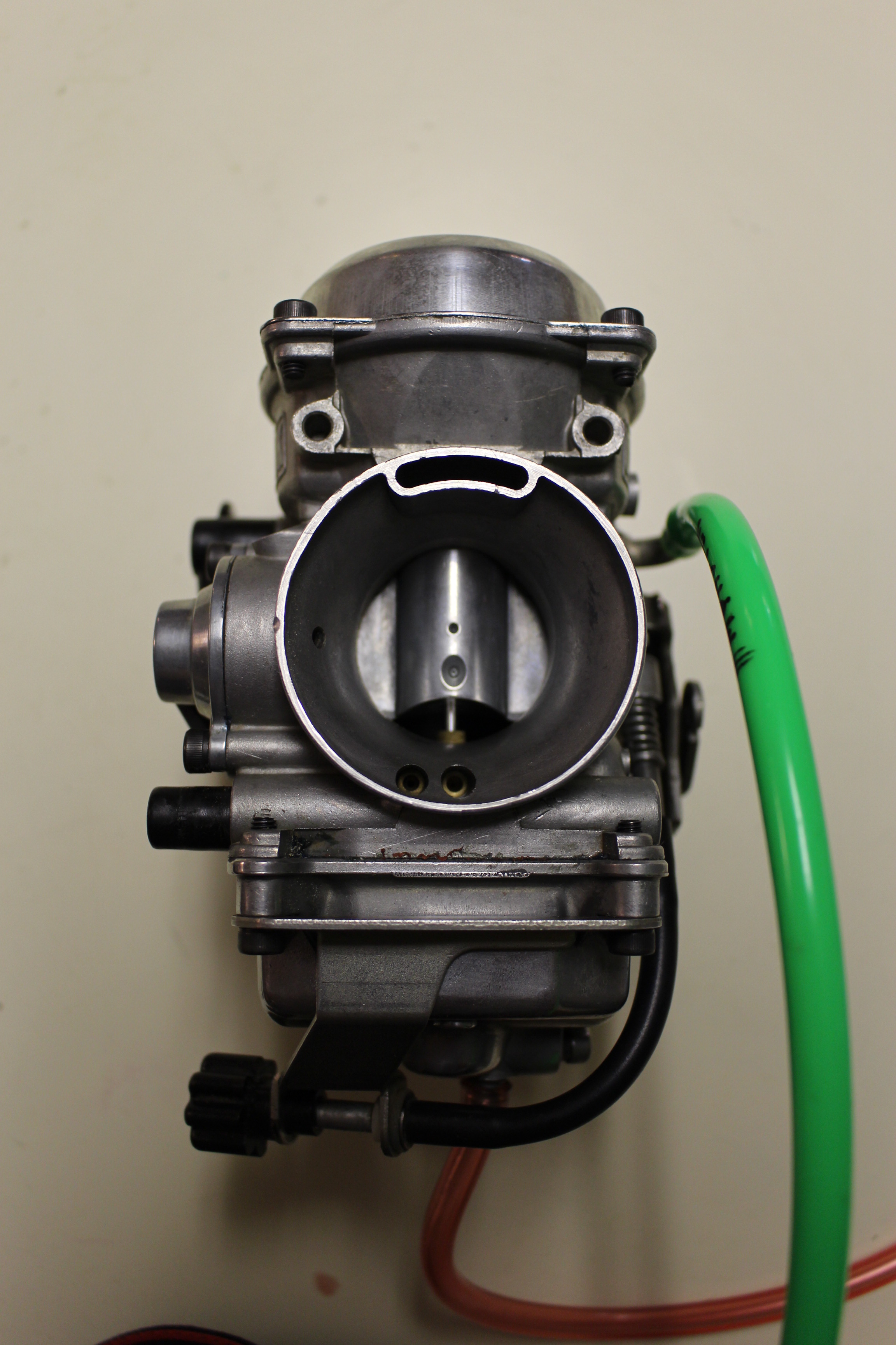

Got the KLX 300 carb in, it looks immaculate. Apparently the top and bottom were polished and the rest of the carb is ultra clean. Its much prettier than the carb in my bike. Dont know how it works yet though.
Few quick specs - came with 35 pilot and K122 main (I think its a Keihin anyway). Swapped the main to a K148. I heard some jingling in the cap, so I opened it up-- apparently the guy who last fiddled with it really didnt know what he was doing-- the needle w/clip was resting ON TOP of the plastic retainer WITH the clip in the 3rd notch from top. This effectively allowed the needle to come completely out of the needle jet when the diaphragm is fully raised.

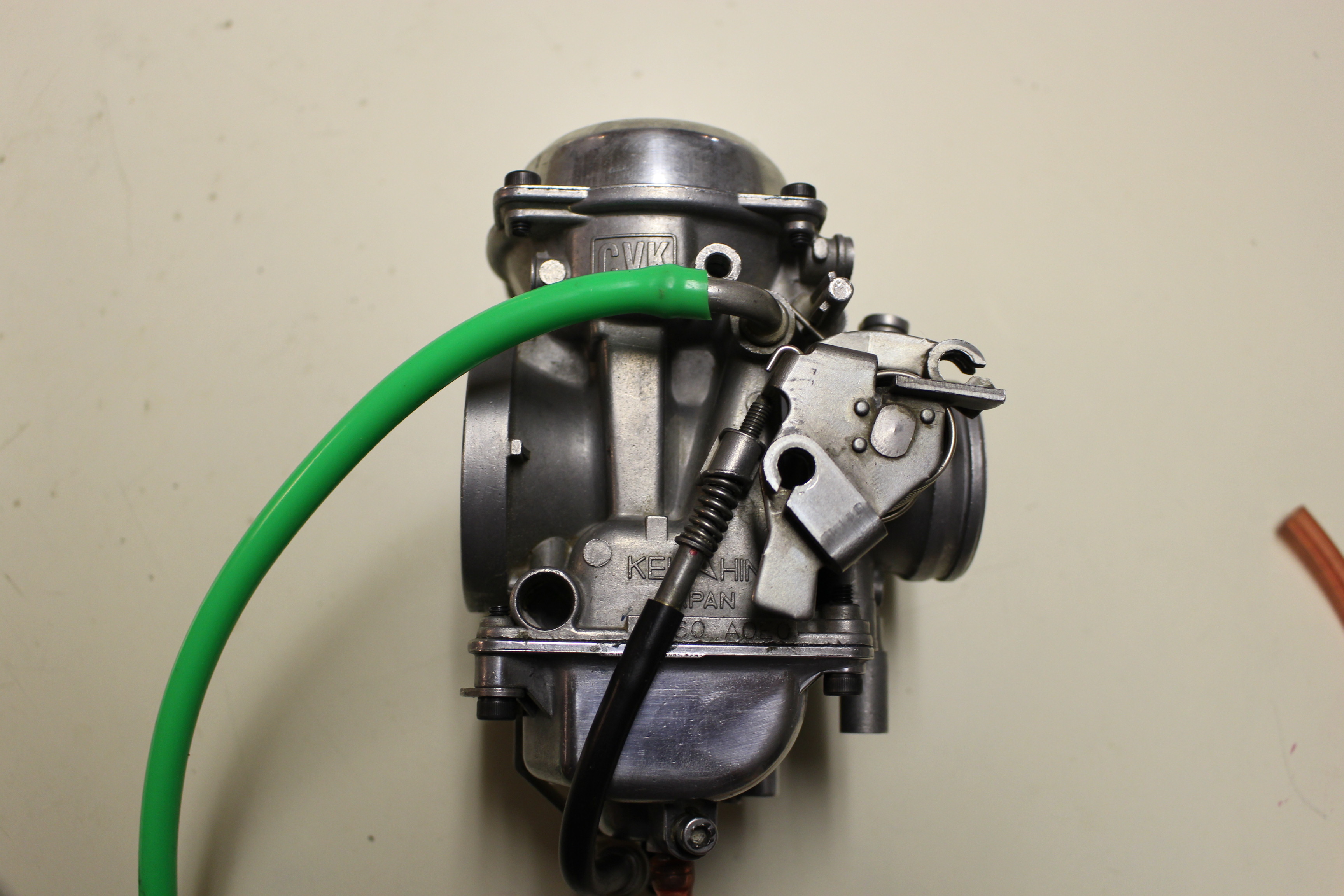

I moved the clip to 2N put the brass washer on top of the clip, set the needle in the slide and then placed the plastic retainer and spring and buttoned it up. Looking at the throttle plate, I can see the screws have been taken out before, but I wonder why?

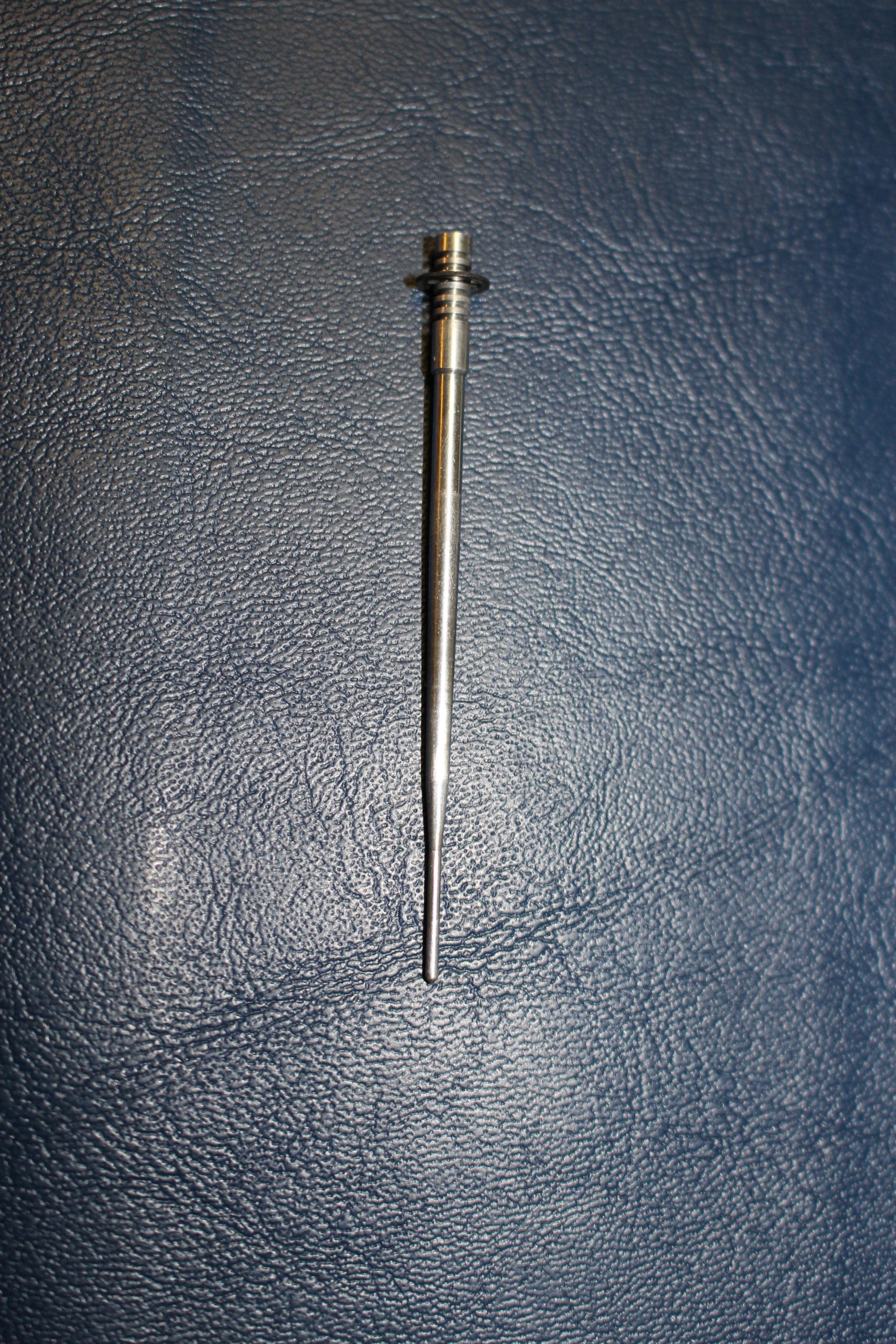

Last, the needle itself-- its not an N1TC-- I dont really know what it is... A dynojet needle maybe?? Check the pictures below, maybe someone will recognize it. It has a more agressive taper and a more rounded tip than the N1TC or stock needles.

That's the DN0352. The needle that comes with the DJ2206 kit for the KLX300. Which means you also probably have a drilled slide and a DJ main jet. That needle looks pretty dirty..
You should be able to "mix and match" the carb parts to determine what is malfunctioning..? Once that is done and your K148/N1TC@1N is back to good working order, we can put together a plan for testing that 352 needle..

The only reason I know of to remove the butterfly valve bolts would be to replace a leaky shaft seal.
It does have the drilled slide-- I had the guy confirm before I bought the carb-- I'd rather it didnt, but now that I know thats not the cause of my problem on the other carb, its not a big deal.
The needle is not dirty, on the contrary EVERYTHING in this carb is super clean-- to the point where it doesnt look like it spent much time in the bike, at all. The yellow color you see is from an incandescent light behind me when I took this pic in my kitchen. As you can see in the new pic, the yellowness "moved" due to the different angle I took the pic from. See new pic.
My plan is to try this new needle first, so if you have a recommendation on notch setting at ~35 ASL, let me know.
