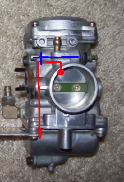

Originally Posted by pwjm
If I understand how to functions correctly, the plunger prevents a vacuum - caused by air passing through the carb. When the plunger is pulled out it allows a vacuum to pull fuel from the bowl. If there is a rubber seal at the end of this plunger and it's leaking, it would allow air to be drawn up (highlighted in red) and engage the enricher circuit. The predominate forces should be working to pull the plunger out if anything.
https://i.imgur.com/c9bNHuu.png
Attachment 7198
That's how I understand it.
Our KLX choke plunger is largely on/off setting.
The KLR system is virtually identical on a larger carb. Under stock configuration with the choke lever on the handle bar, it can be partially opened for partial enrichment. The KLX choke lever can be operated similarly, but it just won't stay in place mid-opening. So, a leak at the plunger/jet interface would seem to act as partial enrichment (rich, not lean). But what if there were a leak around the plunger shaft (have you tried the propane/wd40 leak test procedures)?

Funny that you mention that IDR... KLXster likes to give me a hard time about testing vac leaks like that (lol, as you can see above).
Though I'm not sure how it would be possible to test for such a leak with the carb on the bike - let alone running.
EDIT: Just re-read what you said. I used wd-40 and propane to test for the throttle plate shaft seals, but not the choke. That's worth checking before I remove the carb, for sure. That would constitute a potential air leak, but wouldn't contribute to the enrichment circuit engaging outside of it's normal operation (not that we're sure that's the issue yet anyway).
I think the best bet is going to be removing the carb from the bike today and attempting to seal a hose around the outlet in the mouth of the carb and either blow or suck air through. There shouldn't be any amount of air passing through that passage with the plunger closed. Regardless of the result I'll be taking the plunger out and inspecting it as well.

Originally Posted by IDRIDR
We drill out the enricher jet to about 0.018". I'm guessing stock size is just a bit smaller, maybe 0.016 to 0.017", because very little material is used.
One member a while back did go to 0.18".
FWIW, since it likely doesn't have any effect in the problem.
I took a look to be sure. The pilot air jet is drilled out, there is no enrichener jet showing anywhere. That is the air inlet for the pilot jet increasing flow for the idle circuit, not the enrichener (choke) circuit.
It should not affect the mid-range based on Mikuni charts showing jetting circuit effects. Pilot (aka idle) circuit only runs up to about 1/8 in full control and still a bit of effect as high as 1/4 throttle.
Again, since the enrichener is upstream from the draw of the intake it should not have any sort of positive pressure trying to blow it open. Fact is the cable operated versions have a spring set up used in the piston cable retainer that would essentially allow the piston to float if there was positive pressure up against it. My 650 has a cable set up like that and I've replaced the cable before.
This is just to clarify those functions. I still defer to what Richard said, block the enrichener inlet with some tape or a tiny dab of silicone seal to test it if you think it could be the culprit. Scotch tape would work well and the sticky glue could be dissolved with some contact cleaner or alcohol to release the tape.
Question, will it flatten out when brought up to the range while sitting still? If so, run it without the air boot on it and see if the slide is smoothly operating. See what's going on if possible. Could also block intake a bit with a hand or some fingers in the carb to richen the mix (blocking air).
