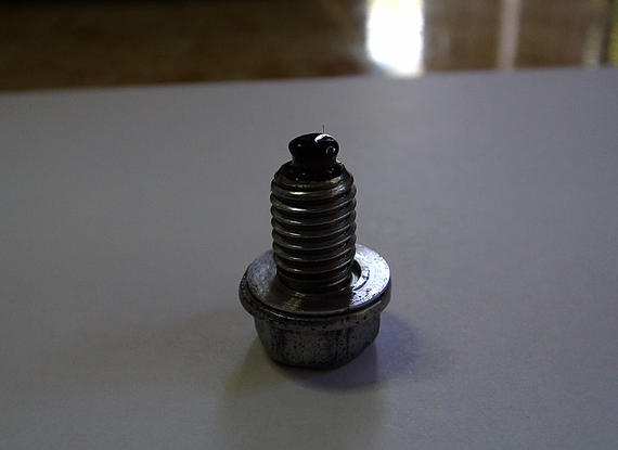

I made my own magnetic drain plug using a high strength rare earth neodymium cylinder magnet from K&J Magnetics.
The results aren't as spectacular as general search photos on the internet often show, but this only has about 200km on it. The oil filter was new btw.
At least there's a little bit of metallic goo that won't be abrading the internal engine parts any more

I fitted a magnetic plug to my (now my sons) KLX250s after the rebuild to catch and steel particles that may have been missed in the cleaning after the Balance bearing failure.
Did an oil change at 100km and found two or three steel particles on plug and some aluminium particles in filter.
100km after oil change we laid the bike down on the grass (left side down) and removed plug and there was a little goo as you show in you picture which I put down to bearings and rings bedding in.
it should be noted that the oil filter is after the pump and the magnetic plug stops (most not all) steel particle from being pumped through it, so the pump runs in unfiltered oil.
