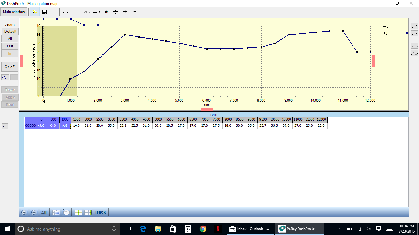

Once 'bomb'd + K158 you can try this curve - This is the final curve I ended up with from reducing the data on over 40 runs - it did measure an overall increase in acceleration (3rd gear 4k-10.5k rpm @ WOT) . If you want to tweak this curve, know that the area to work on would be 8k-10k - the accel increase over stock was not as large in that area as it was in the other ranges...

As I recall we were pretty close on our ignition maps, this is the last screenshot I posted.
I'm thinking the 40 deg advance in the low end seemed to work best for me as I'm a bit rich on the transition to the needle.
I only ever change 1 thing at a time so I will be running the new header before I put the new jug in. I'm going to have the base of the 300cc jug machined a bit to increase compression and slightly retard the cam timing. That will be a complete unknown so Ill get properly setup on the new header first.
