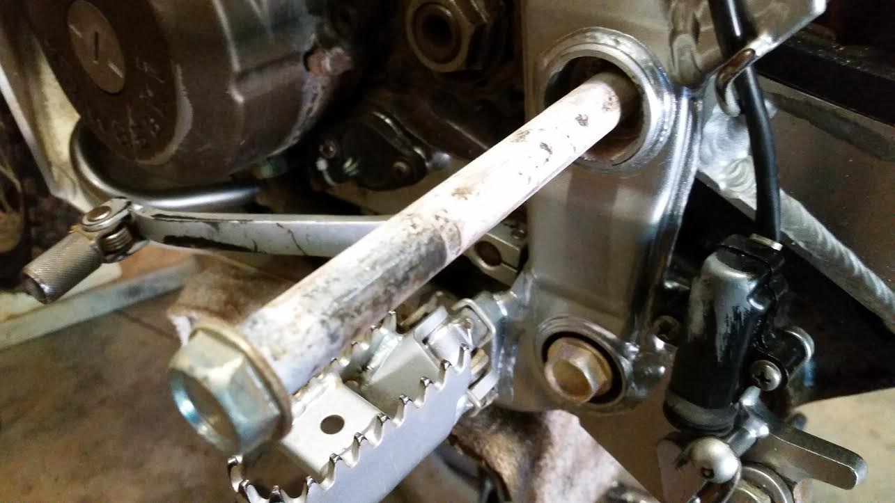

Here's the corroded shaft. Powder was relatively thick. I ordered a new one last night so at the very worse I'll have a spare.

I would reuse that.

Yeah, I'd use that too. The once-in-a-blue-moon case that I've seen is when a swingarm pivot bolt, wheel axle, etc. needed replacement was where the interface at the bearing races/contact points were corroded to the point of seizure and got hammered to the point there were dents and noticeable irregularities at those points. It's rare to get to that stage, but it can happen. The shaft in that pic looks fine.
