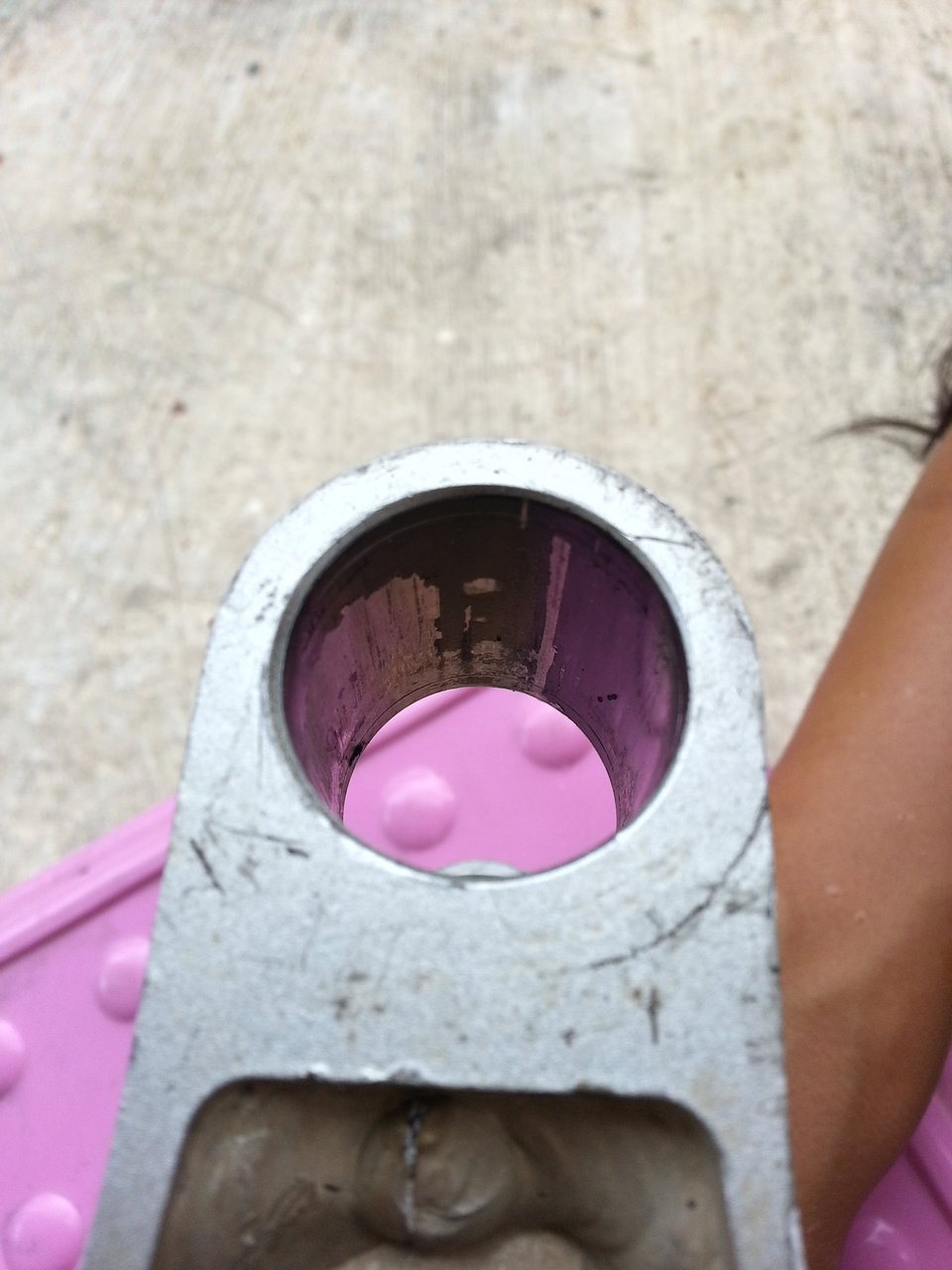

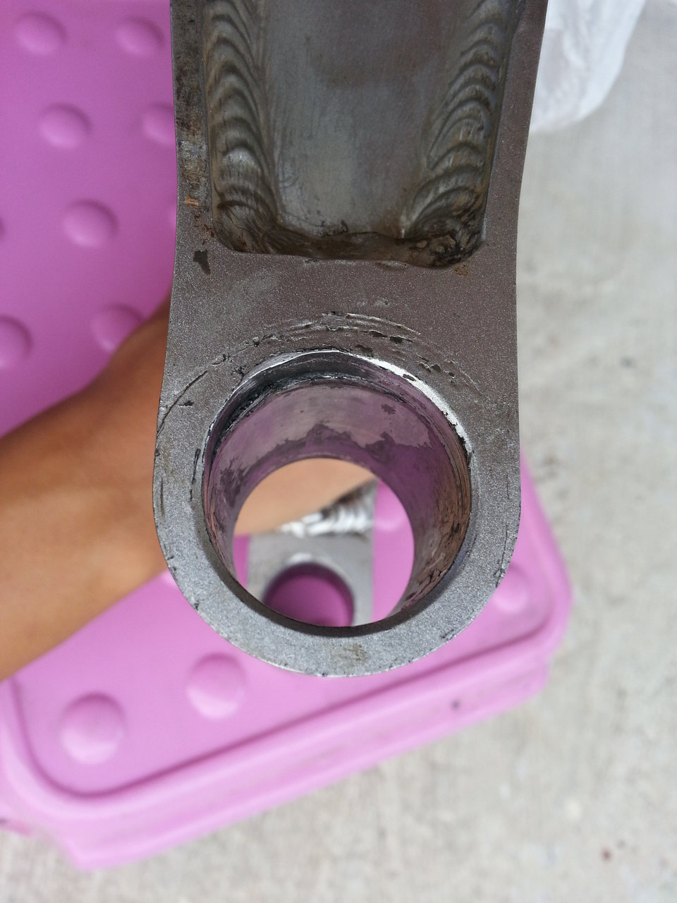

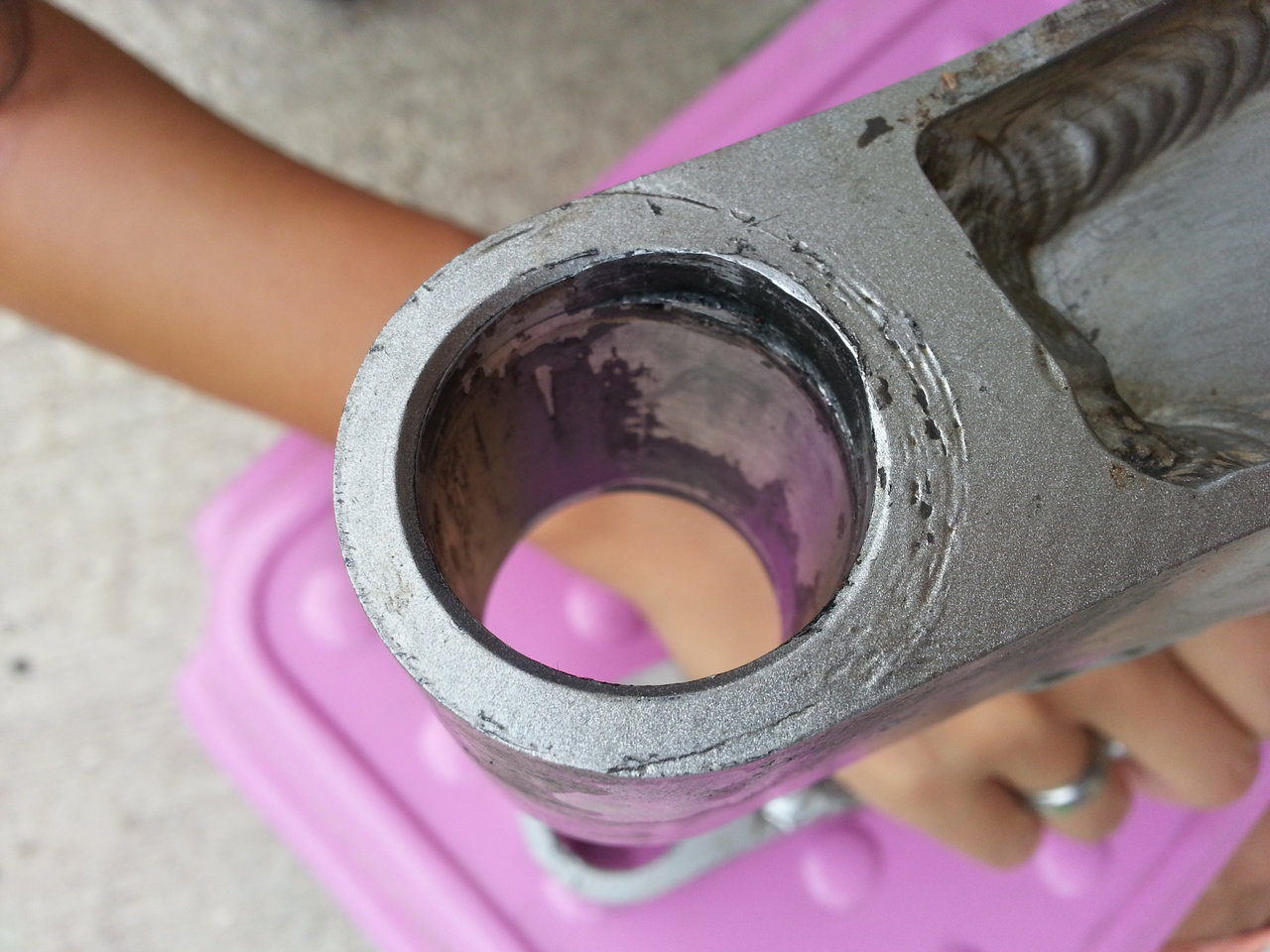

Got a KLX250, took the rear suspension off for inspection/clean/grease job, the swingarm bearings looked new and greased up, but the sleeves were pitted (no rust, though). I guess the mechanic working on that bike before replaced the rusty bearings once, but chose to sandpaper and reuse the sleeves. One bearing had play and another one felt tight, even the sleeve didn't want to get out of the bearing, had to lightly hammer it out. When pressing out the bearings using socket&hammer method, one of them just fell out after one hit with the hammer - fell out too easily, I mean.
On that side there's significant damage to the outermost part of the swingarm surface, where the sealing cap sits. Pictures included.
If I try to just replace the bearings and seals, I'm worried the seals will let some dirt in because there will be some gap due to that damage. So, does this kind of damage warrant swingarm replacement, or are there other solutions (e.g. epoxy)? I prefer to do a proper job. A new swingarm is $130 here in Thailand, + all the bearings.
Thanks!

Yeah, in addition to it looking like someone ran the bike until the bearings were absolute toast, it looks like a monkey wrench job of installation and removal at some point. Still, the swingarm is probably usable. On possible slop in the bearing/swingarm interface, try some bearing retaining compound. Loctite makes a good one. You could epoxy them back in, and in all honesty, you don't have to press them out each time you need to clean and repack the needles...as long you can thoroughly wash out the grime and grease. It's worth a try and only involves a little time investment...in addition to the bearing retaining compound, of course.

I agree on the new arm for that low a price. One option if you had a machinist that could do it, would be to turn it to a press fit and put a steel shim inside with the ID to fit the bearing. But I'd think it would almost cost as much as the new swing arm.
Of course TNC's suggestion makes sense to because it can't cost that much to try and if it fails you just get the swing arm.

Is that swingarm aluminum? If so, the damaged area of the hole could be welded and then re-honed. But at what cost, I dunno. I have to agree on the $130 swingarm. That sounds like quite a deal.

Thanks for the suggestions guys. The swingarm is aluminum, and welding/re-honing or having a steel shim fitted at the machine shop would be the "proper job" solutions, unfortunately I live in Thailand countryside and don't have a reliable machine shop I would trust this thing to. With the average quality of Thai mechanic shops (they are cheap but not that careful) I wouldn't trust just some shop I find by chance on the street.
I was thinking about trying to get that retaining compound, and using silicone on the seal, on the other hand I have to get new bearings first, and then if I fail, there will be another trip to the Kawasaki dealer to order a new swingarm, and another 1-week wait to get the part (or a 250km trip to the main dealer in Bangkok who stocks the parts).
So the price seems good to you guys, I also thought that's pretty cheap for a nicely welded aluminum swingarm. Given that my old swingarm also has some damage (previous owner was using it with a worn-out sidestand that would hit the arm in the up position, and over time made about 3mm deep groove) maybe I should just replace it.
