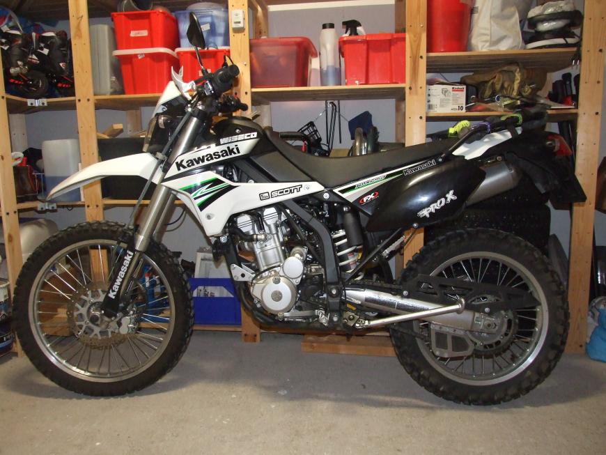

I Purchased the 2011 model of the EFI KLX250S in March and I have being modyfying it slightly to suit my needs since then. First thing I did was to replace the OEM silencer with a Leovince X3 dito (with O2 sensor plug mount) and replace the stock snorkle with the KDX dito. The completely legal X3 adapter was OK but it was clearly restrictive so the power was really dropping after ~5000rpm (I made the famous clutch-switch-shortcut to avoid the rev-blocker). The open exhaust adapter really opened up the breathing of the engine but I instead figured it was a bit too loud. At the moment I have again installed the "legal" pipe but I have drilled a set of holes in the pipe to get the "best out of two worlds", and I must say I am pretty happy about the "loudness-power" compromise.
Another thing I noticed is that I could for sure use some more seat height and ground clearance. For this reason, I installed a set of raisisng links today but I have not been able to test them yet.
